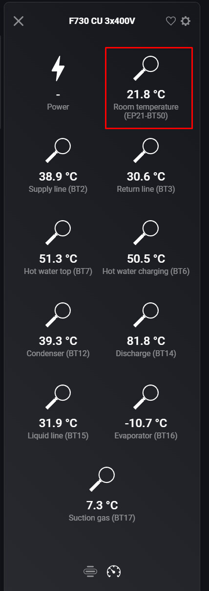

I managed to find your datapoint EP21-BT50 on the list of datapoints on the device configuration page:
I copied the datapoint name “Room temperature (EP21-BT50)” from the “datapoint names” textbox to the “Datapoint name for capability 1” field, and I can see this datapoint on the list of capabilities:
You can also use this datapoint names on flow-cards as following:
Finally, you can also use this datapoint on an insight:
Does that answer your requirement?

Yes It do and basically I was a moron.I just used the sensor name inside the brackets not the text as it was written. Rumstemperatur (EP21-BT50). A small matter remains, there is some translation issue. All the Swedish special characters å,ä and ö are gone.

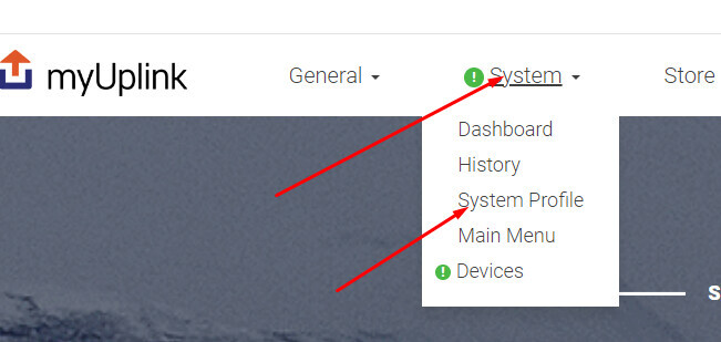

  1. Browse to MyUplink webpage: https://myuplink.com/
  2. If you are not logged-in, login with your credentials
  3. On the top menu, choose “System” and then “System Profile”:

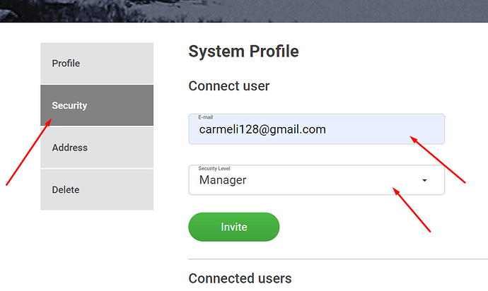

  4. On the left menu, choose “Security”. Put my email (carmeli128@gmail.com) and give me a “Manager” level. Then, click the “Invite” green button.
    This will invite me to your home, and I will be able to test on your device.
Sure thing! I’ve sent you the invite. Thanks in advance!
