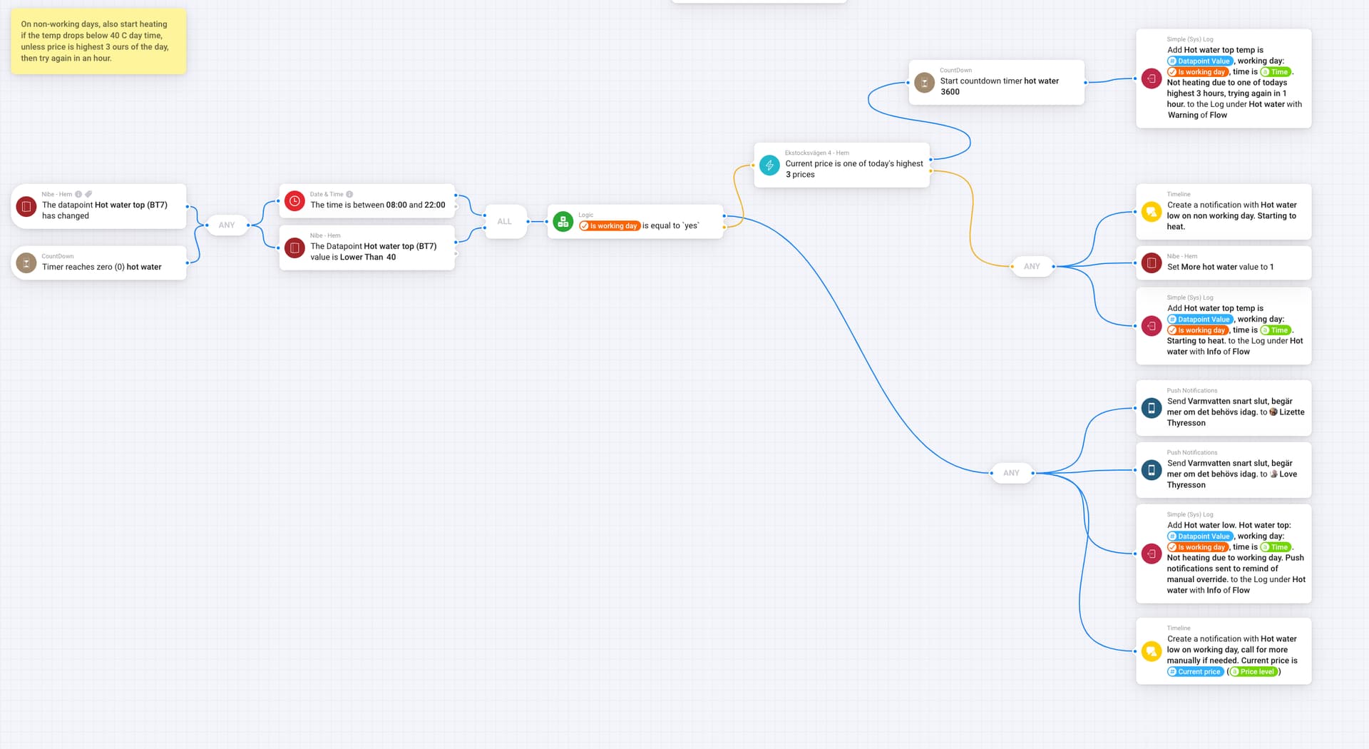

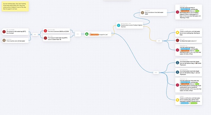

Yeah. kind of. Now it triggers every time the value changes, not only when it drops below a certain value. You’re right it it doable, I just need to keep state myself instead using some sort of “hot water is low” boolean to avoid certain parts of the flow from executing everytime the value updates. :slight_smile:
This is the flow I used before :slight_smile:
