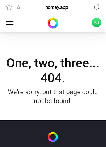

Also interested in this app and would like to install the app but when i press the link above to the test-app it seams that the app isn’t avaliable:

@Kristian_Jonsson - the next version of the app is in review process by Homey. Once they are done with the review, the test-link will be up again. I assume it will be by the beginning of next week.
Glad to se you are interested. Please send feedback once you start using it.
Ah! Of course! I will come back with feedback as soon as the app is available. Thank you for the work!
