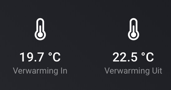

My statement about the temperature showing the Wong way around is not correct. It’s from the heat pump perspective, so outgoing water is ‘hot’ and incoming water is ‘cold’.

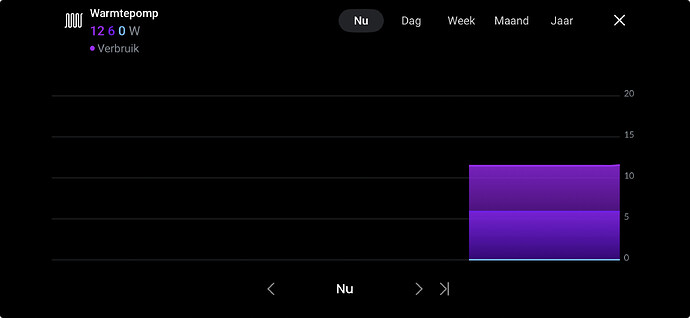

@Kenny_S what installed meter do you have and how do you read the values of that meter? I have this one, but not yet able to read the data [APP][Pro] Eastron - Advanced Energy Monitoring with DIN Rail Meters over Modbus TCP - #7 by Wout_van_den_Dool… Also wondering if it is on a separate fase implemented… And have hopes I can read per fase via Homey P1 powermeter…

I have the 3ph pm from Homewizard installed, readout is through the Homewizard app on Homey.
I also have the 3ph pm installed you have installed. This is shown in the Eplucon app and can be used as you do to trigger the Pump, but I’m not using this. These are the house values and not the pump values, kind of a P1 meter.

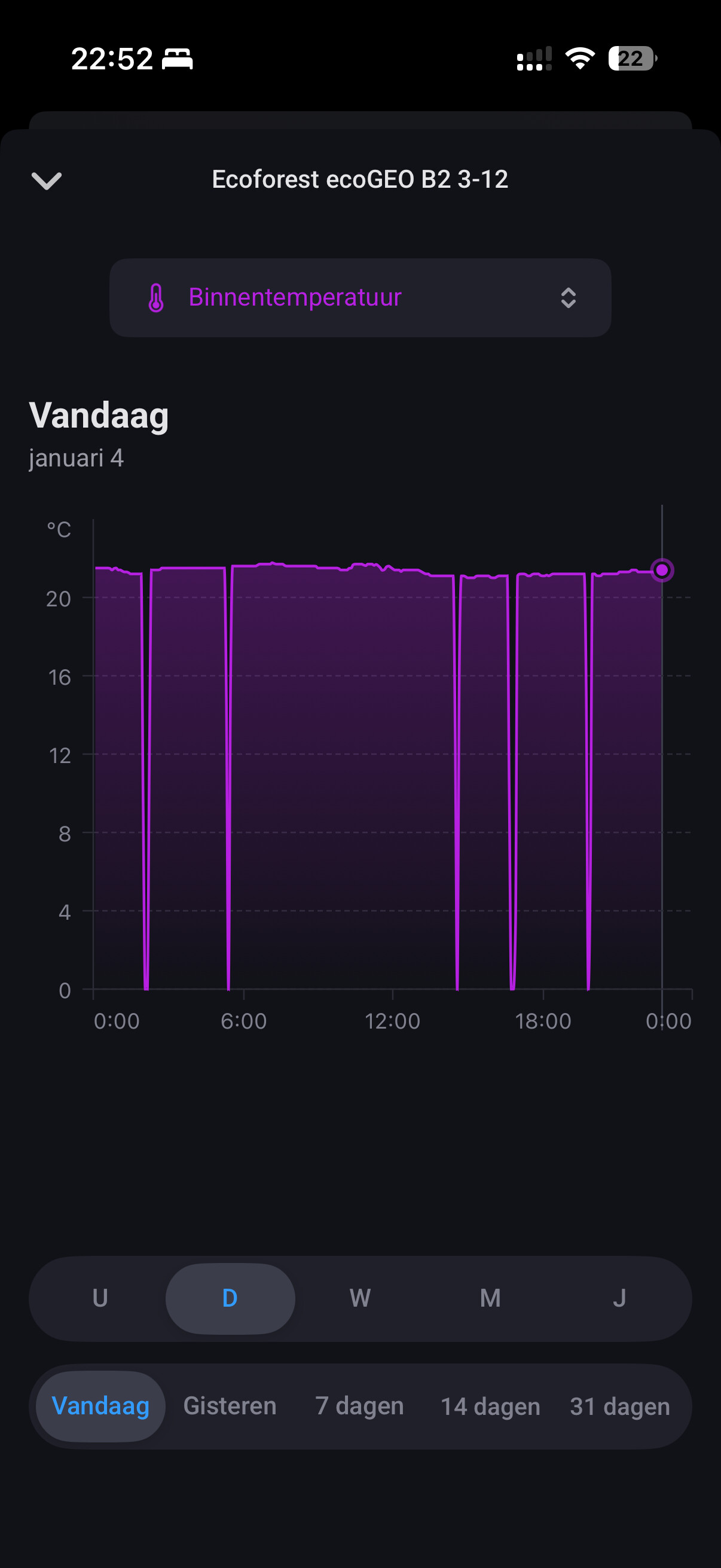

Awesome that you made this app :smiley: . It works great for me! So glad to finally have my ecoforest in my homey. It seems though sometimes some values are updated after 2 hours, 1 hour, 3 hours (random it seems) instead of every minute. Is that what it’s supposed to do?
If there is no updated value, then you see the latest moment that value has been updated…
Ah allright, so it means the value has not changed since then? It only updates the value when it changes? Got it thanks :slight_smile: . It also sometimes updates the value to zero, I have that with all the variables. Any idea what that might be?

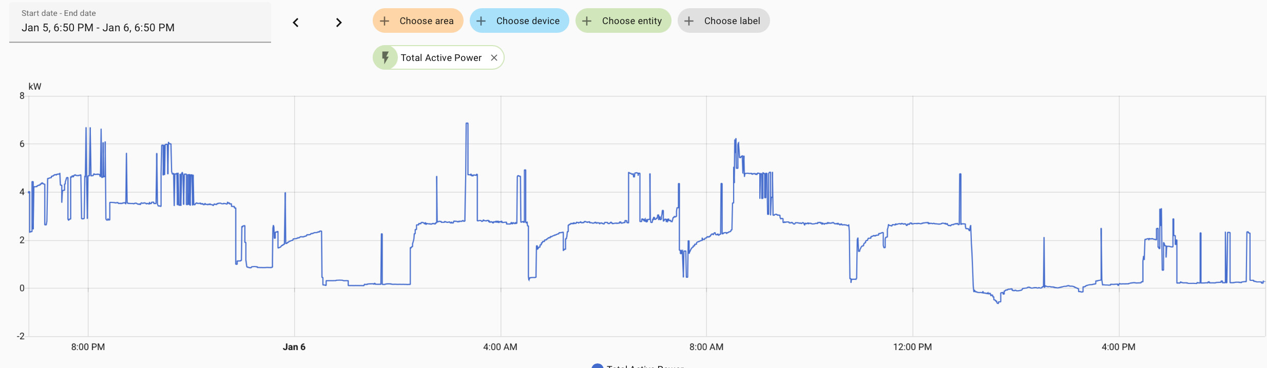

I noticed a strange value, “ total active power”:
It seems to have some kind of relationship with the energy usage because the peaks are kind of in the same spots as the power meter… but the value is in the range of 0,3 to about 6W.
This is by the way exactly the same as in the HomeAssistant integration, but nevertheless, strange what this value means.
