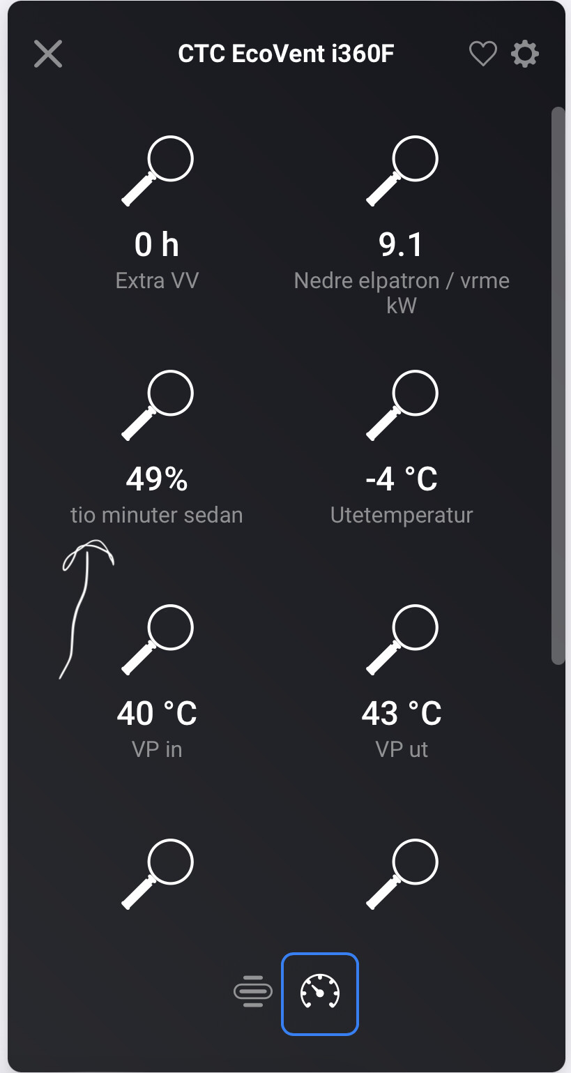

Really appreciate your efforts!
Log one after save: 138dd194-987e-410e-be7c-018d036f3577
All values refreshed.
Log two after 10min: 030061cb-c4b1-441f-b0d7-d63dbe94fbc0
Value stuck for 10 mins

Are you sure that the value of this item was supposed to change within those 10 minutes?
Where do you see a different value? On the Phone-app of the device?
Nothing has changed for 4h now but now you making me wonder. All those values are quite static.
ATM i have same values on myuplink. I did change the “Tid till filterbyte, d” param to “Tid till” on my last config change suspecting the , would crash the api call. Maybee it helped I will give it some time and report back the results. By tomorrow I defiantly know due to the filter change param.

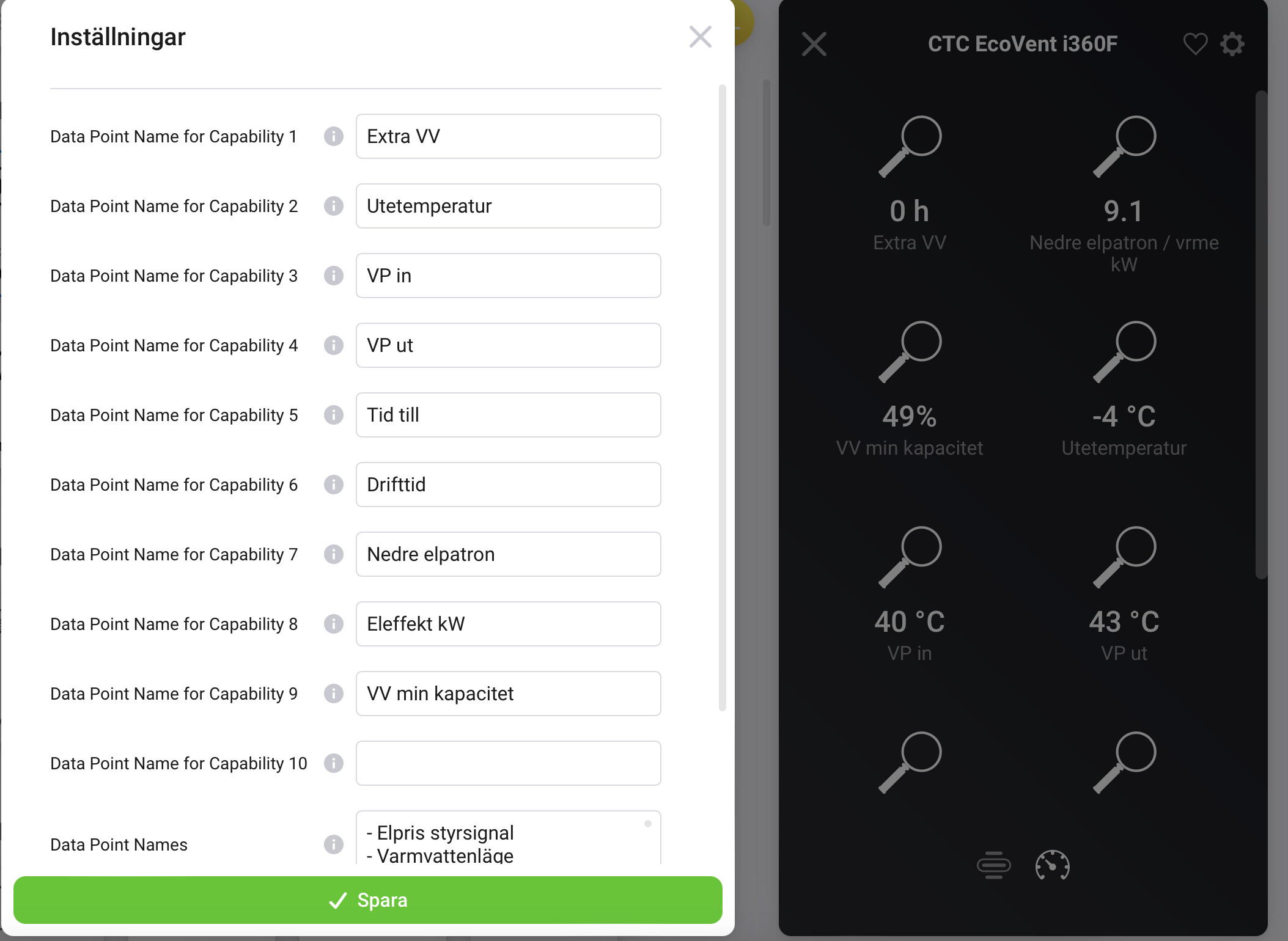

Guys - I am trying to help someone with a NIBE-F730 pump to activate the app. No luck so far.
Does anyone has an F-series heat pump and is willing to share with me privately a Client-ID and a Client-Secret, so I can compare between the two?

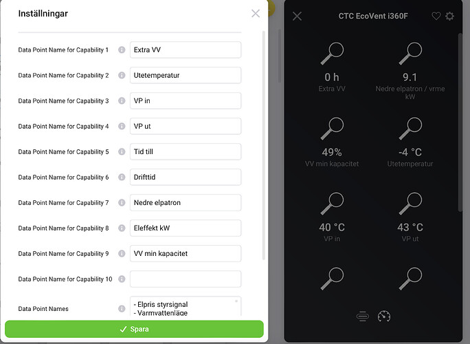

One thought I had though, where are you getting all the strings for values to add as capabilities? I mean, I just took 10 that looked interesting, but in hindsight I am thinking one or more maybe is not available for my specific heat pump? if so, it would be plausible that this causes an issue when adding illegal capabilities? So before I try again, maybe shed some light if you populate the list from my specific heat pump, or from a generic list from myuplink?

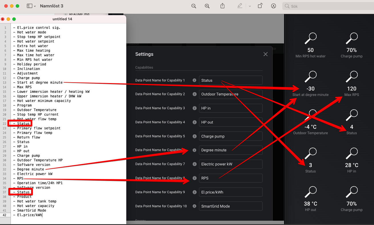

Ok, so I have re-added my heat pump now. And looking at the 3 places of 1. All options given for capabilities and 2. What I inserted and 3. What is used, well its a mess. Please have a look at the attached image of what gets there with what I have chosen.
  1. There are two names Status. I added one, and got both
  2. I added RPS to get the actual currently running RPS, but instead I got both other RPS related for Max RPS and Min RPS hot water
  3. I chose Degree minute, I got the Start at Degree minute
I would say a deal-breaker to get right =) Im sure you understand =)
Log here: 4cce963f-bb24-4027-ad1c-bd5f66ab702b

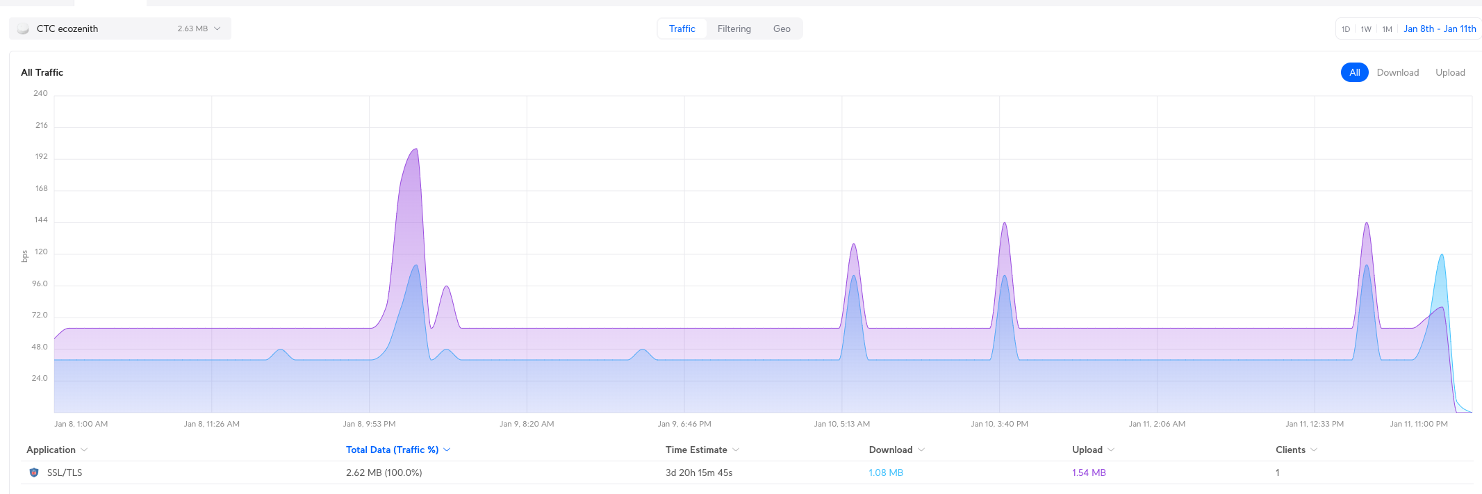

I had just gone to bed after it all looking ok. But the heat pump direct UI was unavailable. After disabling the Homey app again it is now working again.
It sure looks like there is some issue. Not being able to monitor the heat pump with my phone at home will also make it hard for me to get this app running…
Looking at the network traffic, it sure looks like spikes, but it is not very much really. Might be worth reaching out to the myUplink team. I may consider it

The algorithm is going over the names you placed on the config window, one by one.
For each item you have, I am going over all the datapoints your device has. Each datapoint that contains the string you put, will be added.
So - if, for example, you type “hot” in one of the options, I will go over the list of datapoints and will insert “Hot water mode” and then I will insert “Hot water set point” and then “Hot water minimum capacity” and so on. So one config item will add 3 datapoints to the capabilities window (or maybe even more).
Now - let me explain the behaviour you have seen one by one:
  1. Typed “status” and see two “status” that were added - this is simply because your device (from some reason), has two different datapoints with the name “status” as you circled it in red. So I went over the list, found the first one, added it, and then found the second one, and added it two. Notice that their values is different, so its actually two different datapoints with the same name (maybe you can look at the documentation of your device to understand the difference between them)
  2. Added “RPS” and got “MaX RPS” and “Min RPS” - going over the list of datapoint, you would see that the first item that contains the word RPS is - indeed - “Max RPS”, and then “Min RPS”, and then “RPS”. I guess I hit the first one and added it, and then when I got to the second one (Min RPS) I had no more places left (we are limited to 10 capabilities) so it was not added, Same for RPS itself.
  3. I chose Degree minute, I got the Start at Degree minute - Same: looking at the list from top to bottom, the first item you find which contains the words “Degree minute” is “Start degree minute” and then, when I got to “Degree minute” in the list, there wan’t a place left anymore…
I guess that the only way to solve this confusion is to be more strict: I can look only for exact matches of the names you put in the configuration. Not checking if the string is contained in the dapatpoint name, but only if it’s exactly similar (I can maybe be flexible of the case - be agnostic to uppercase/lowercase).
So if you put RPS for example, I will only look for a datapoint with the exact name of RPS. “Min RPS” and “Max RPS” will not be added.
This will require the user to work harder - he will have to specify EXACTLY the name of the datapoint. Not only part of it.
On the other hand, the results will be much more clear.
What do you think? Will it be better?
