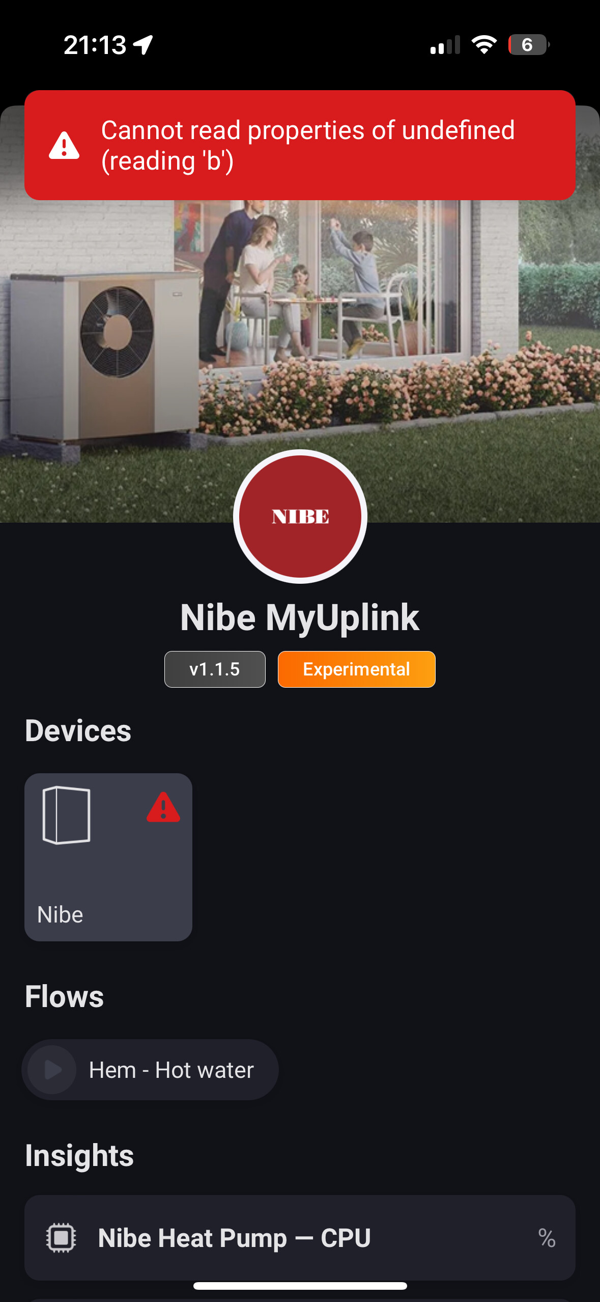

Since 1.1.4 my device doesn’t start anymore :confused:
Please send diagnostic report
Done, I added a new device also. Same thing.
Settings page suddenly looks like this too
Wait, you ars on tbe test link.
Please uninstall the app, and reinstall the formal version from Homey app store
Oh, thanks!
Fixed it :pray:
The settings are dirty because of the test app.
But this shouldn’t affect the connectivity.
Remove the device, add it again, and send diagnostic report again
