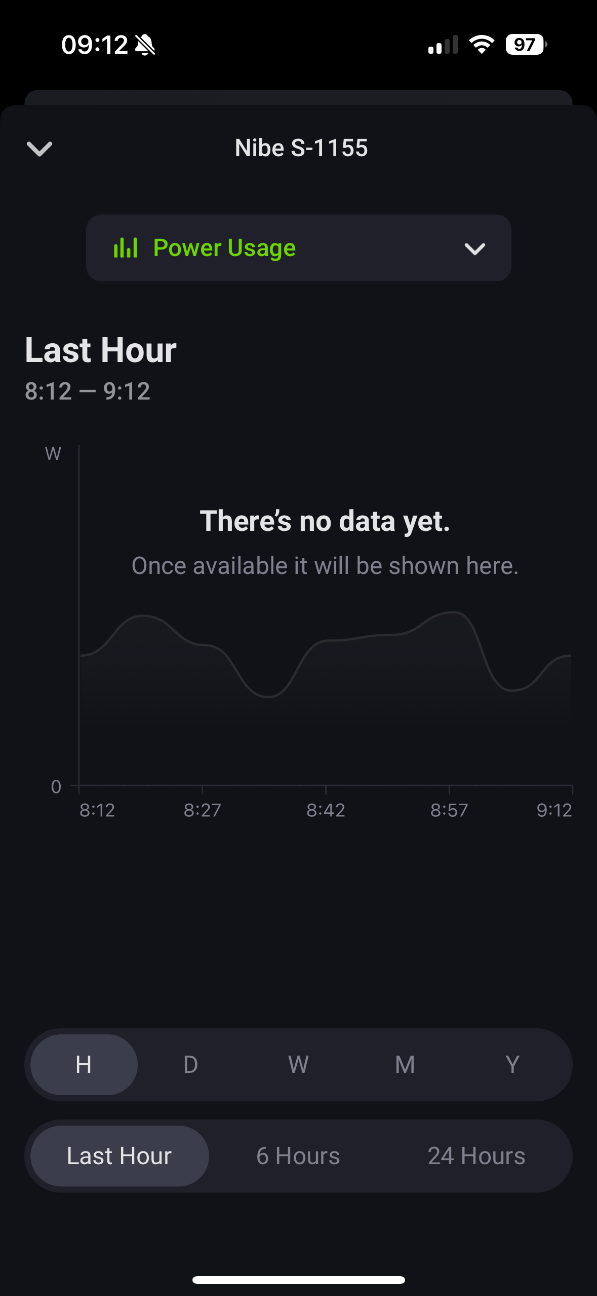

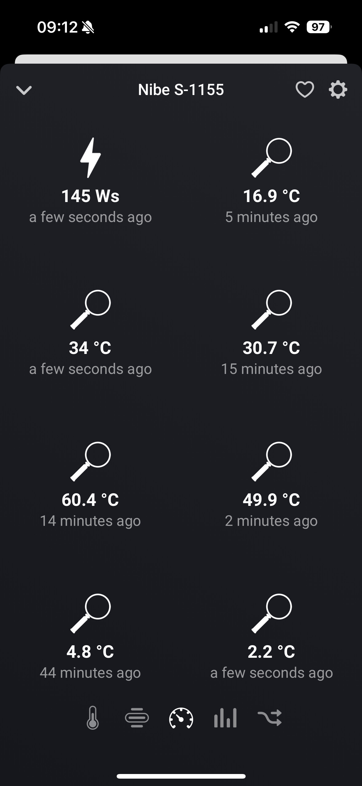

Is there a specific datapoint you are trying to add as an insight, or you can not add any of them?
None of them. No history at all.
Interesting. I will check it.
I do not see the problem, seems to be working fine for me.
