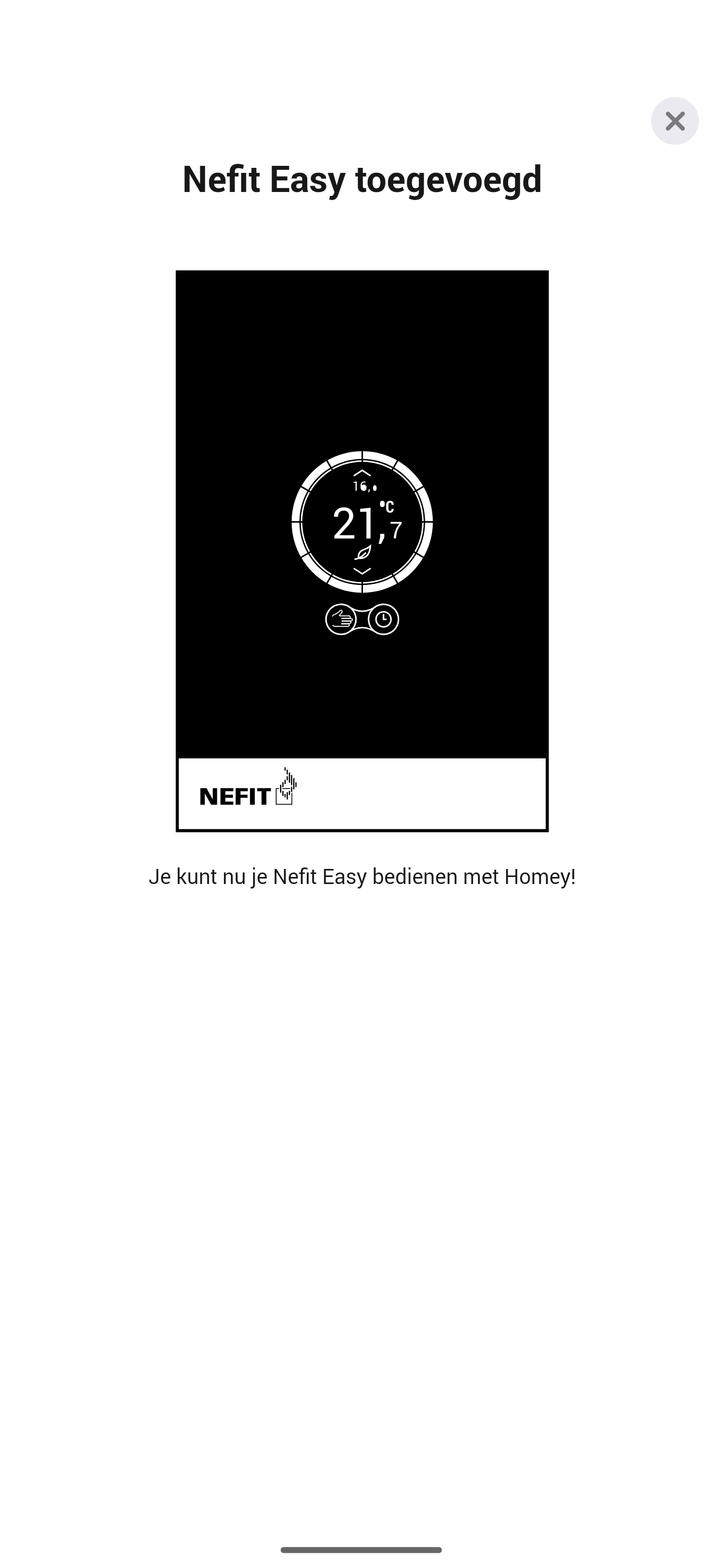

Good day all, I just installed an HP2023 with the Nefit Easy and the App.
But it gives me these errors…
Any ideas to resolve?
It shouldn’t be possible to change those capabilities from the UI. I’ve just published a test version of the app where they should be removed.
Since I don’t have a Nefit Easy myself anymore I cannot test this, so please let me know if this fixes your issue.
Unfortunately the same error.

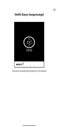

When installing the app, and its ( i guess) finished.
There is no button to end installation.
Maybe app not installed correct?
There’s a close button in the top right corner.
But like I said, I don’t have a Nefit Easy anymore so cannot test any changes. I assume that even though changing the thermostat mode doesn’t work (which it never did anyway), the rest of the app still works?
The x asked me to abort installation.
The rest seems to be functioning oke, main error is select program or manual.
The listening error for mode and central heating
