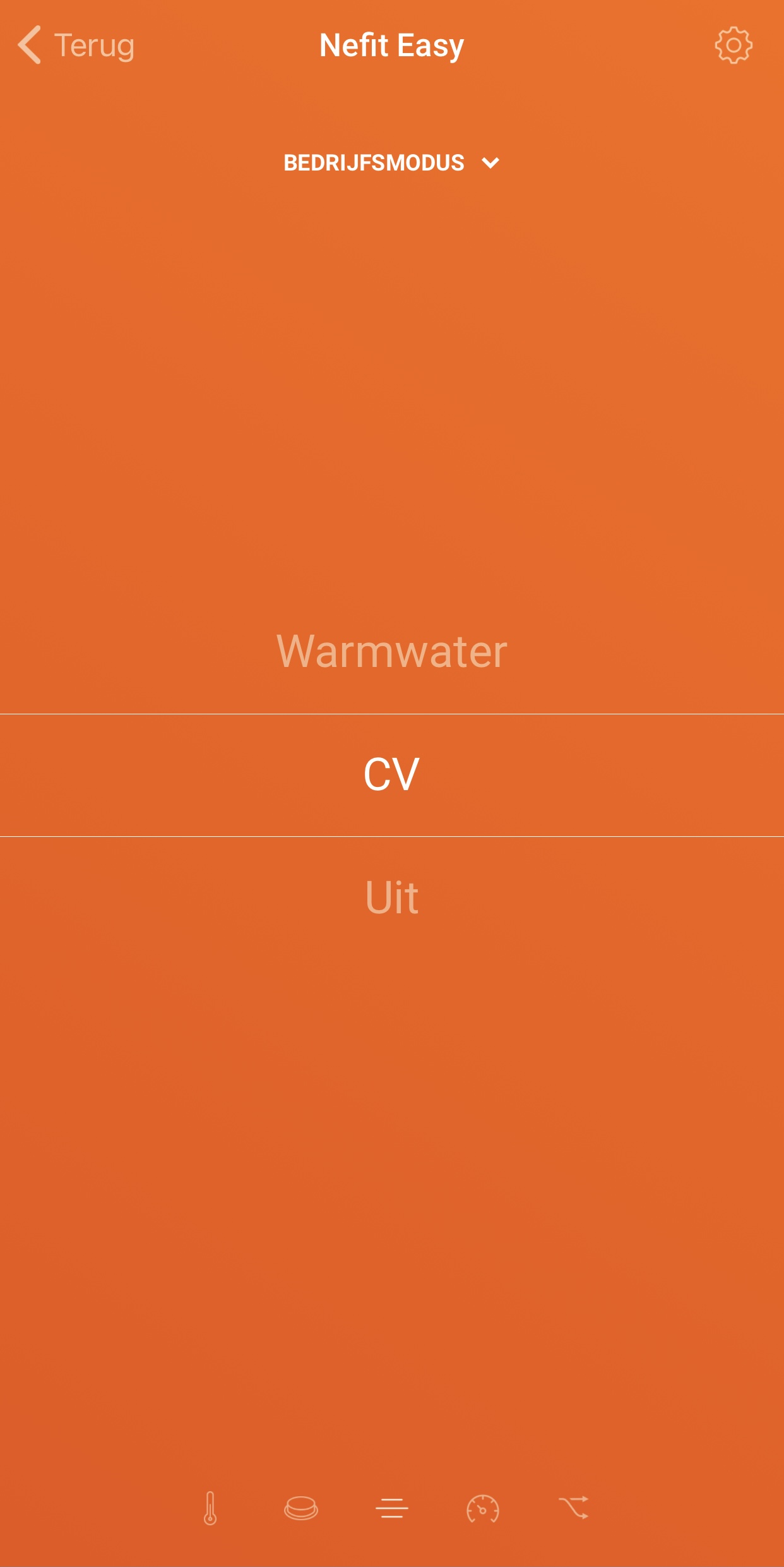

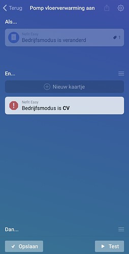

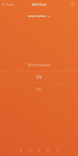

Hi @robertklep,
I get you are not developing the app anymore, but do you have an explanation why the flows aren’t working when the ‘Bedrijfsmodus’ changes and the ‘Bedrijfsmodus’ is X, it doesn’t respond start a flow as expected.
When I log the ‘Bedrijfsmodus’ changes to a file, I get ‘central heating’ and ‘hot water’ instead of ‘CV’ and ‘Warm water’. No idea of that’s a problem or if this is just the translation?
Yes, there’s a mismatch which makes the card fail. Instead, you can use a Logic card and compare the operating mode token against central heating.
@robertklep
That works, thanks!
