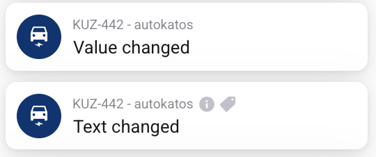

Would it be possible to have trigger cards for when a specific number capability changed. Now there is only become greater / less than
There is also Value changed, but it doesn’t tell which value.
That trigger would be particularily useful for latitude/longitude changes to tigger GPS to address flows to update current address.
Also there is the Text changed, but now the question is which string capability, I have two in the configuration?
That is standard Homey logic.
Every numeric capability gets a higher/lower flow trigger generated.
But only main capabilities get default flow cards generated (value changed).
The app has two custom capabilities for generic values (measure_string, measure_number) wich such trigger cards. But also only for main capabilies. I think the trigger cards are coming up from these capabilities.
Ok, I’m using the measure_number for all numerics, since there is no standard capability for the number values I use. So yes, there are sub capabilities quite a few.
