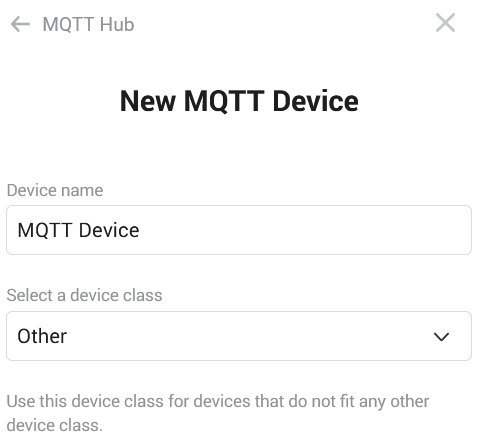

But I’m stuck at step 2. The list of possible device types doesn’t seem to contain anything relevant. What should I choose?
Problem is your MQTT value. It’s not a simple number, it’s a complex JSON object.
So let’s start:
Create a MQTT device, the type is not relevant.

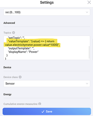

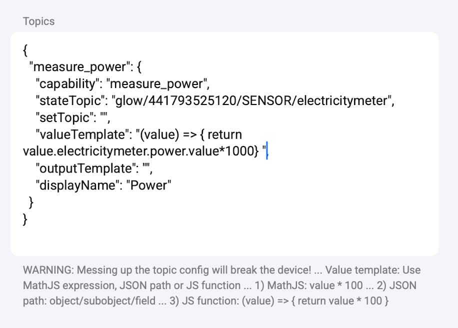

Go to device settings. Exchange the valueTemplate line with:
“valueTemplate”: “(value) => { return value.electricitymeter.power.value*1000}”,
:tada:
Thank you @RonnyW for detailed guidance. I will give this a go and see how I get on.
Thanks once again @RonnyW . I got stage 1 working - the device happily pulls through the current power value in W. But I still can’t get the valueTemplate working. When I make the change I think precisely as you describe above, when I hit ‘Save’ on the device settings, I get an error message “Invalid Value: class”.
Can you see what I am doing wrong?
In device settings is a field ‘device class’ where no value is set. Please select ‘sensor’ and save. This should work.
It seems I added class change without checking for blank value :sweat_smile:
Aha! That’s got it working now, thank you. I’ve also managed to get the cumulative energy usage showing up in meter_power and included that as a whole home energy meter in the energy tab now so working very nicely.
