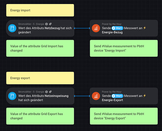

Until now, I have imported the MQTT data from my Hichi IR electricity meter sensor (Tasmota) to Homey via Home Assistant (HA → Home Assistant Community App).
I am currently in the process of changing the data import via an MQTT Hub device, which I have managed to do in general.
What I’m missing is a flow card especially for the imported and exported energy, like I had with the HA Community App:

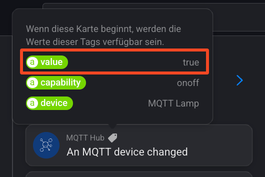

The MQTT Hub app also provides the following similar flow card:
– An MQTT device changed (but just with text tags, even for values):
I tried already different kind of flows for reproducing the HA Community flow, but with no success.
Am I missing something?

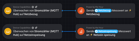

BTW, to ensure that the recordings for the import and export energy in the PbtH devices are not interrupted, I’m currently using a flow card from the Device Capabilities app:
Edit
@RonnyW, is it possible to add a similar flow card like the one in your HAC app?
