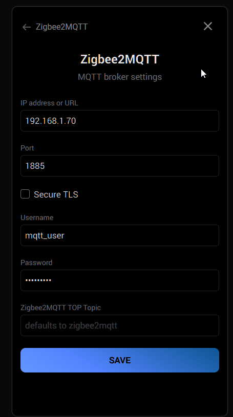

:white_check_mark: 1. broker is running with username and password on local port
:stop_sign: 2. Can’t make it work with certificate, but for now it’s okay.
:stop_sign: 3. Most important, the zigbee2mqtt app can’t find my broker… :confused:
Any ideas?
Pls show your mqtt broker config as well, then we can go check :grin: :wink:
Oh, btw, do you use port 1885 on purpose? By default it’s 1883
And Homey’s IP is 192.168.1.70?
Yes i use 1885 because my HA broker is using 1883, and I was not sure if something would go wrong.
Yep, that’s my ip i get from the settings.
It comes here:
Btw the error i get in Z2M with/without SSL
chrome_EzCV58eSvq
chrome_vu6cLjAHAw
You’ll need one broker in your MQTT setup.
I think you need to tick the box “Also allow unsecure connections”, which means http
