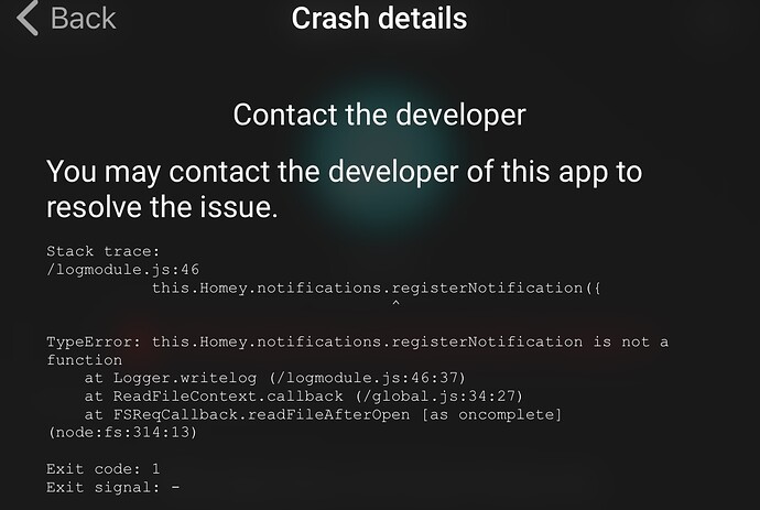

@scanno after the update to 3.0.0 the broker stoped working. after restarting the app it keeps crashing.
I have the same problem. It has been rock solid under v2.0. Any idea of a workaround or fix planned?
I have the same problem. After the update the app crashing.

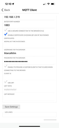

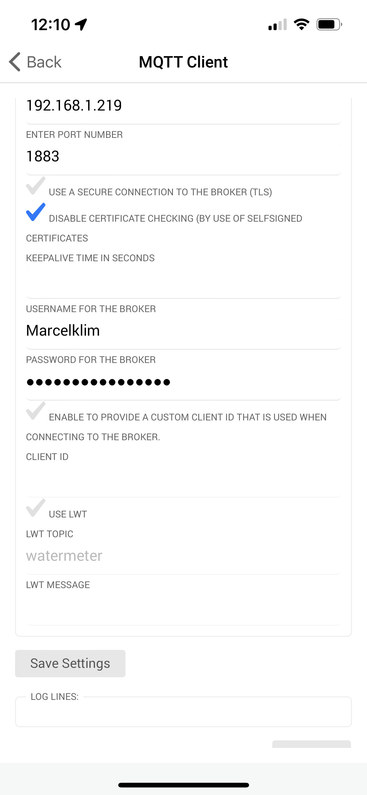

These are the settings for the client

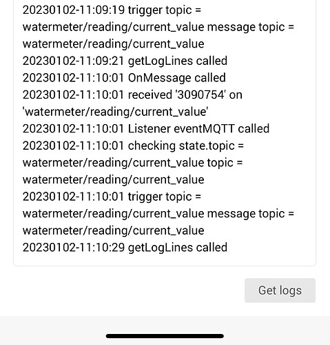

I get these messages

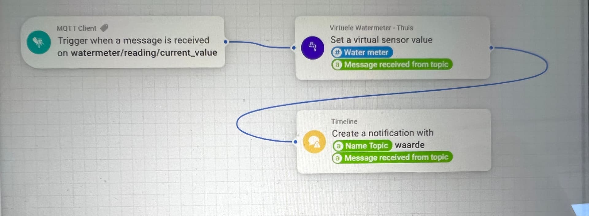

Made this flow to set the value on a virtual device
But it seems i am missing something

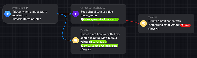

At ‘Set a virtual sensor value’ you should enter the capability yourself, like meter_water (do not use the blue tag).
You don’t see a timeline message, while the sensor card errors, and stops the flow. Connect the timeline card to the output of the mqtt client trigger card.
Use the error line as well, so you can see a bit more of what is (not) happening.
Something like:

Great, this was what i was missing. It’s so simple when you know it😁
