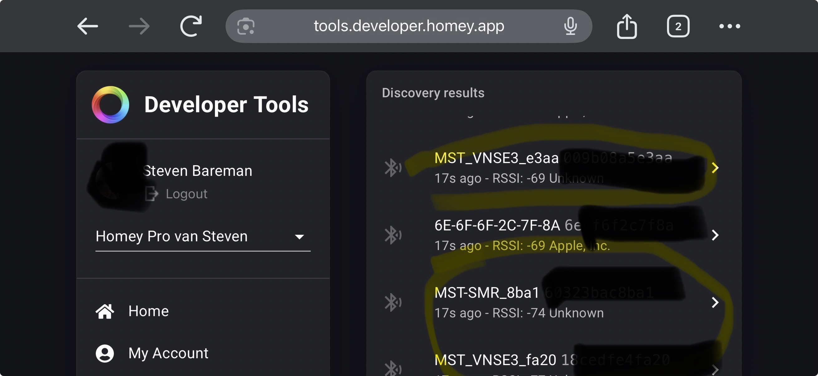

All, I’ve implemented a Bluetooth communication driver into the app, but I’m having problems with my Homey model to connect to the battery. Can some of you help me find out if this is an issue on my side, or a limitation of the Bluetooth hardware used by Homey.
If you have access to Homey Developer Tools - Can you please connect to a battery (if listed) and use ‘Discover Services’ button and see if the ‘Advertised service uuids’ shows and array of unique IDs?
If that shows anything with some of you, then it is worth releasing…
I can see them too.
I am not sure what the Blutooth lock does in the app. But it is enabled, and i still can see them.
But: Services, No services. And i see only one VNSE3, but have two
Thank you for the quick feedback! I’ve also upgraded to the latest experimental firmware version, and I now have working BLE connection and data retrieval! It needs some polishing, but I’ll try to release as soon as possible in the TEST channel for you to try!
I’ve also implemented several flows that allow to reset the battery, will be included in the BLE release!
The empty array square brackets after Advertised service uuids shows the problem I was also having. I’ve upgraded to the last experimental firmware version, and they now show. Please read the experimental disclamers before upgrading…
