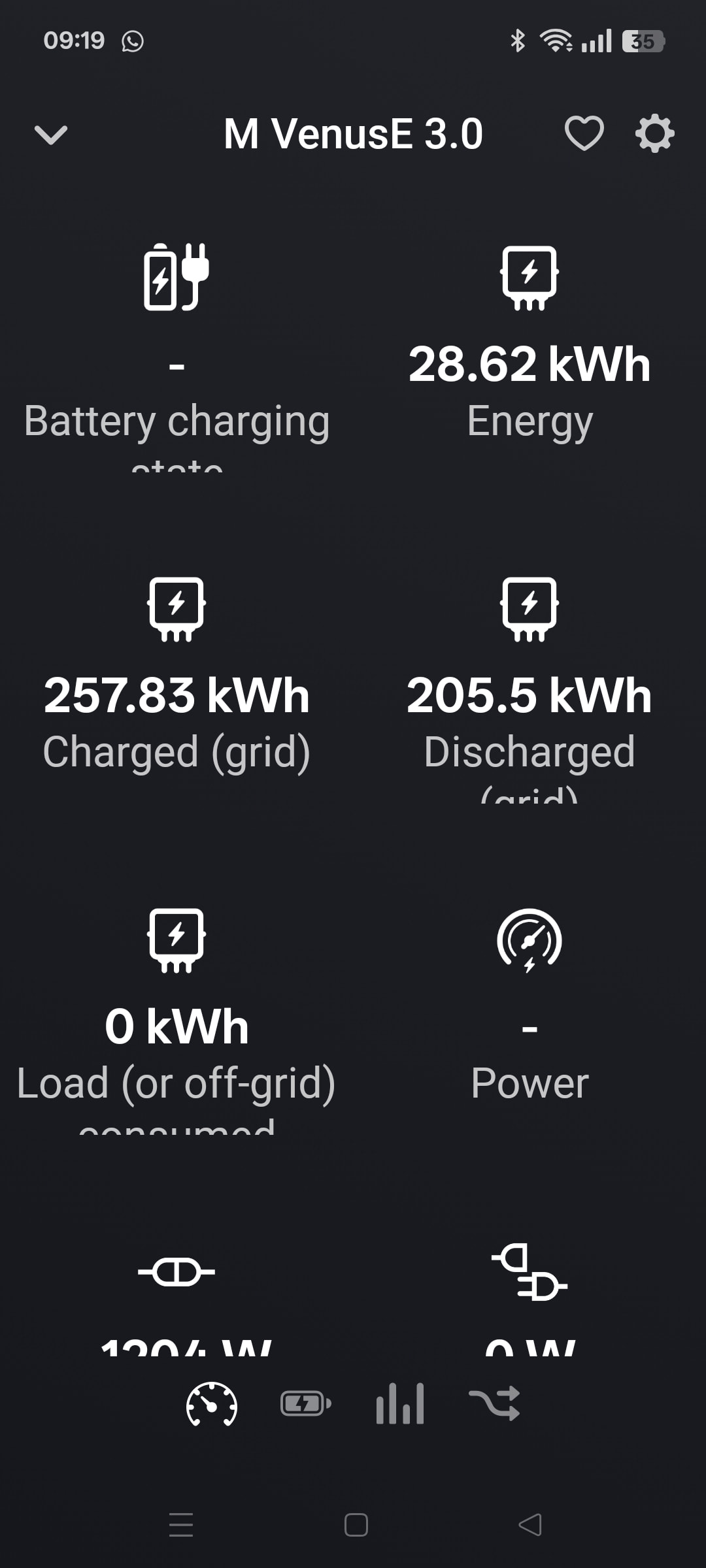

Hi, I have just purchased my 1st Marstek Venus E v2 battery and as most of you trying to hook this up to the Homey to be able to regulate te charging/discharge in combination with the EV charger and solar panels. Some observations/question after reading this blog:
  • As stated I purchased a Venus E3 type. It was delivered with firmware 135, BMS 106, inv 111. As I had the same issue of connecting through the API connector (also using other Homey - Marstek apps) I requested through the Help&Feedback of the Android Marstek apps for a new firmware. I have now received and installed version 144, BMS 107 and Inv 116. Question: is the firmware versions for the E2 and E3 the same? If so how to obtain the latest version (145???) ?
  • Using the app v0.8.1 and the Bluetooth tool I am now able to connect to my battery. Looking at the different parameters on the Homey device I see some are not being filled in (battery charging state and power, last refreshed 56 years ago). Some of the parameters are off by a factor of 10 (Energy, charged and discharged) and last but not least the refresh time are all different: some a day ago, others a couple of hours and some parameters minutes ago. Is this normal and how to fixed the read out of the missing parameters?
