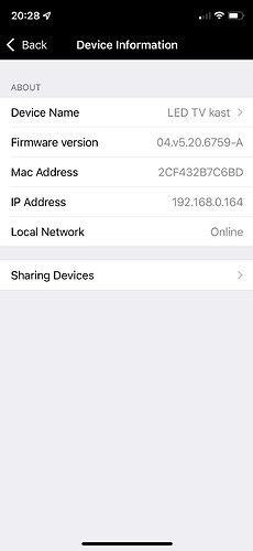

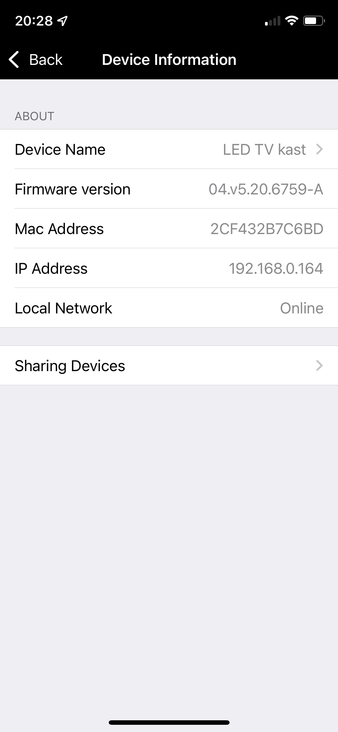

@DidierVU
Do you mind sharing your device settings?
Maybe we can figure out why the other people with the same controller have issues with setting colors via Homey.

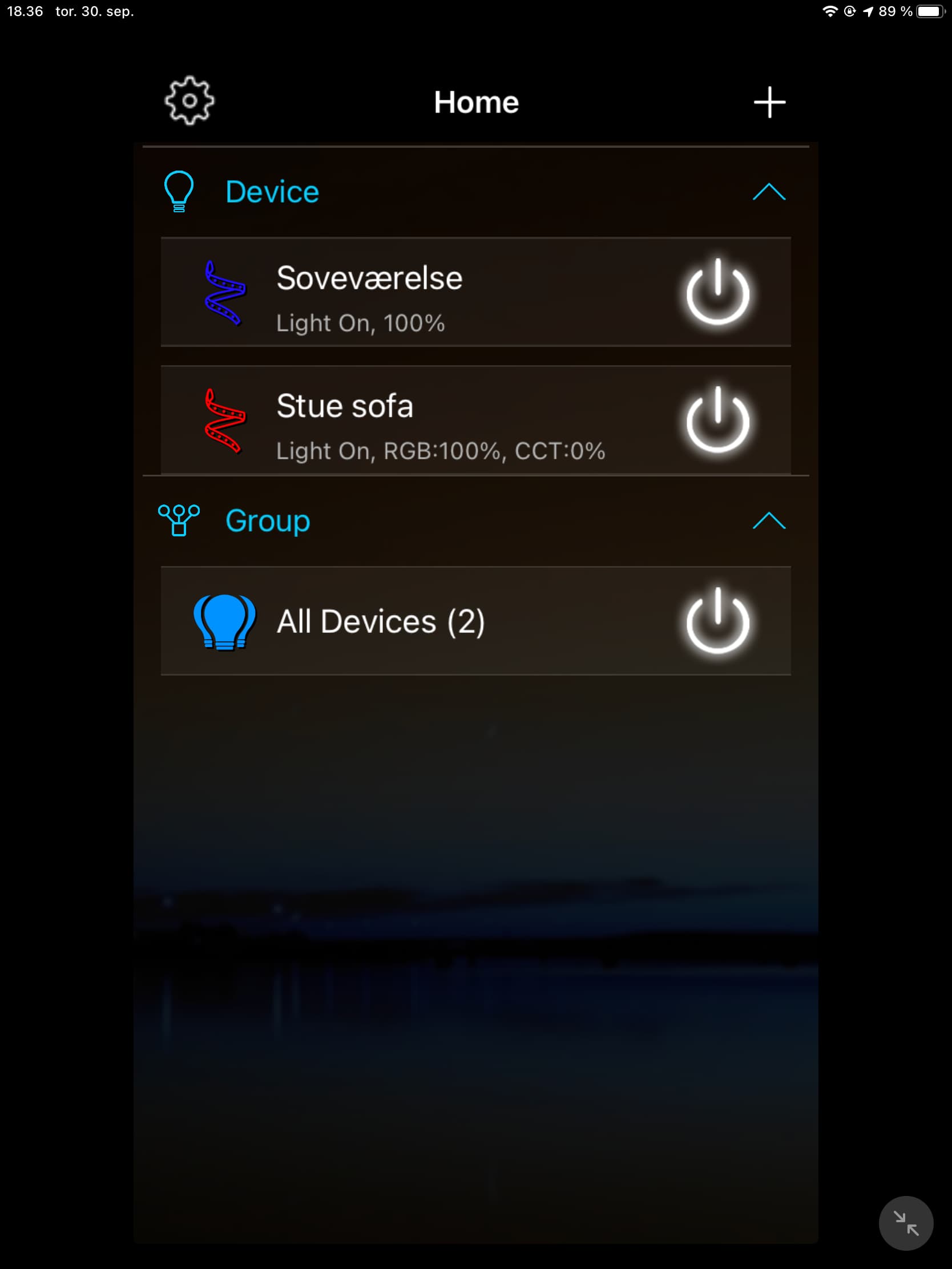

Settings like this:
@martijnpoppen In Magic Hus app one device is RGB and other RGBCCT.
CCT(WW) is recognized on both device in your app, but dont work. Should only work on CCT device.
So one strip is RGB and the other is RGBWW?
I think the controller supports them both. So that’s why it’s recognized.

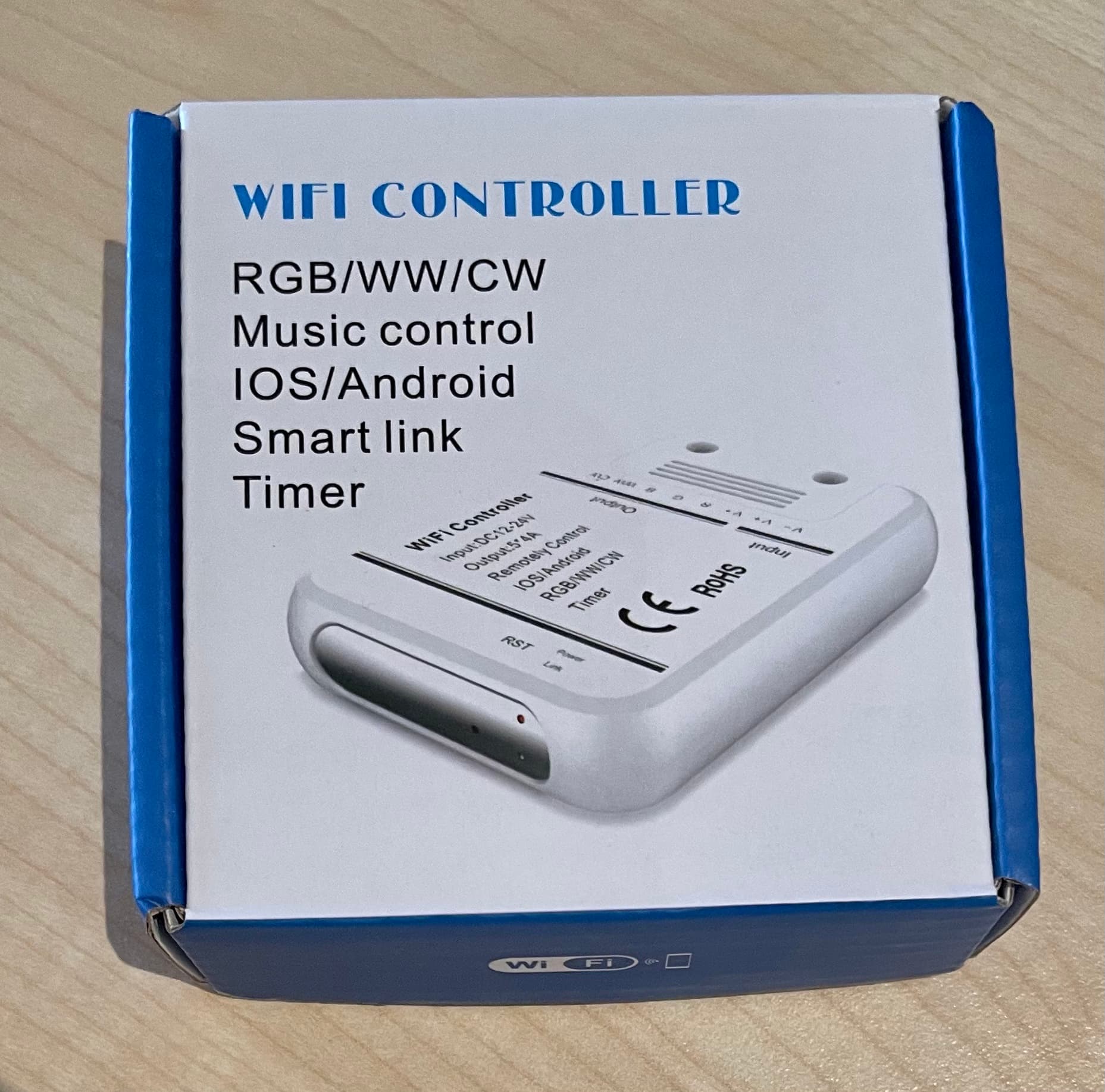

@martijnpoppen correct. The controller supports 5 type of LED strips for $8
In Magic Hue the controller itself find out what type and only shows relevant controls for the LED’s
