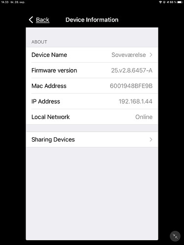

I fyou can provide me with a bit more data like a model number would be helpful. Something like Ak001
Yes, same issue as above, only on/off working.
I will see if I can find a product number, but I wasn’t able to find on my order at AliExress, see link in my previous post.
