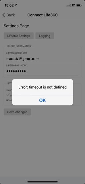

Thank you, but i still get an error: ReferenceError: timeout is not defined, do i need to do something else?
Maybe restart the app en try again.
Did you also install the android app and create an account?
Restarting the app did the trick! Thanks!
Hi, I am experiencing some issues. I also get the “timeout error” when I’m trying to enter my credentials in the homey app. After a few times there is no possibility to press the save button.

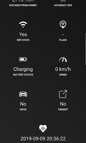

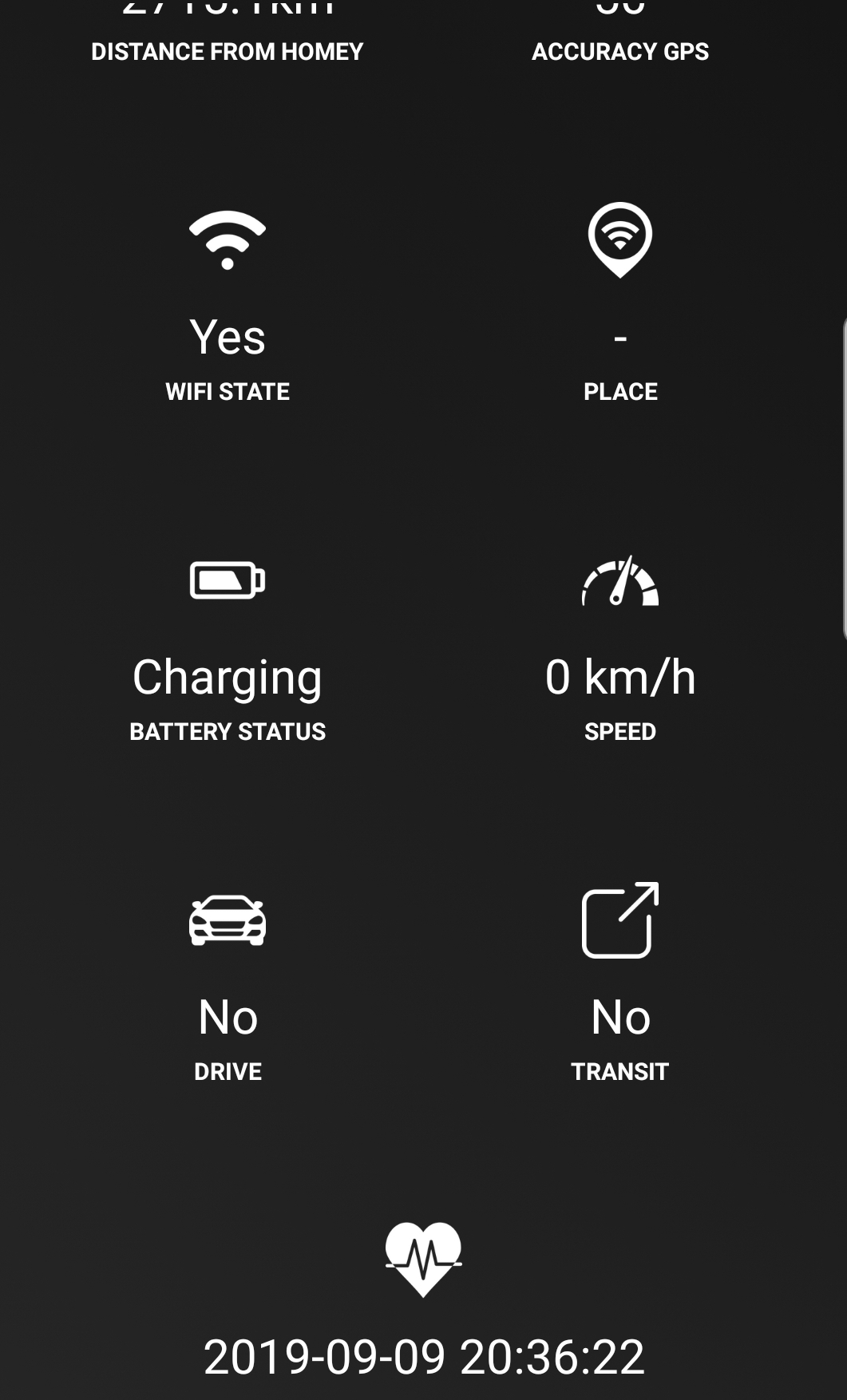

Hi. Am not able to login to my Life360 account from the “Configure App window” in Homey app, I get the time out error. But when I try to add a device, it works (after entering credentials again). I get the right info on the device:
But when creating flows, I can only choose from one location, despite the fact I have several locations. I have also tried to restart and reboot

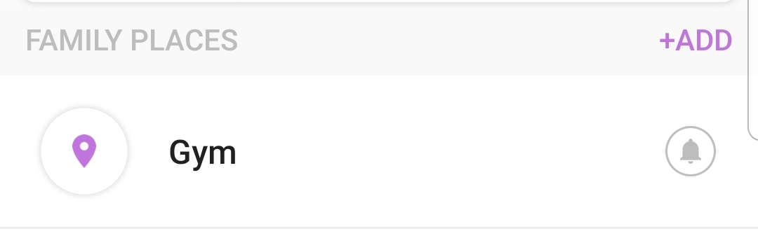

@MarcelT, do you have any idea about my issue, that only one location is picked up in Flow Editor, while there are 7 locations in Life360 app?
Please see above. This has to do that the api only display it when you press the bell in the life app.

Hi @MarcelT, thanks for response. Not sure what you mean, but I guess you are referring to this bell here
SmartSelect_20190914-234327_Life360
What is needed of me to include this one?
