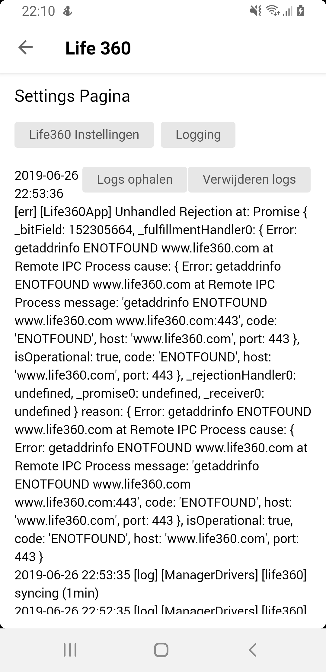

Hi, I think your internet connection dropped. I will check if I can better handle the error.
I’d see the same value’s that triggers the “Device kwam binnen” flow trigger.

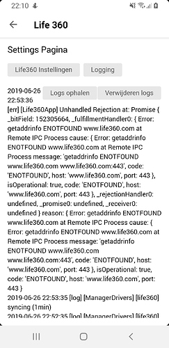

My life360 app on homey stops working every time. After a minute of 15 or so. A restart helps, but only for a limited time. Somebody else with the same problem? Or a possible solution?
Could you send me the logfiles? I think this has to do with internet connection…
Do you mean “Maak diagnostich rapport”?
