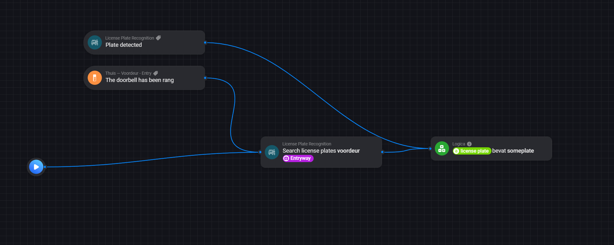

Okay, I figured it out, it now works.
Advanced Flows do not work yet is my assumption. For others, this is how I got it to work:
Create 2 normal Flows.
Flow 1 (trigger)
If: Motion sensor or something (this flow is started is easy to test) sees motion.
Then: Search License plate card (use a camera that is able to create a snapshot in Homey)
Flow 2 (Logic)
If: License Plate recognized
And: Logic → Test logic
Then: Do something.
Advanced flows work the same. But indeed, you need 2 flowd as you already found out.
