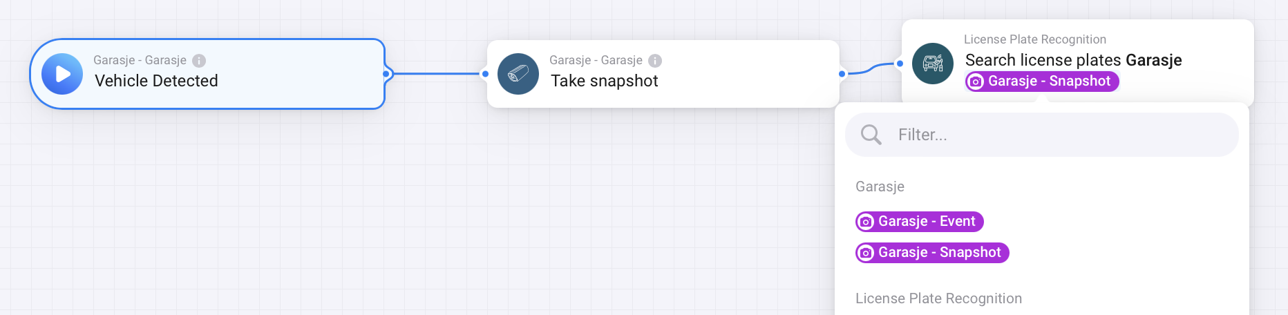

Sorry i have not been specific enough!!!
It is the first “A smart detection event” does not fire!!
The push notification does not come at all - so i assume there is not detected an event or it is not catch by the Homey?
What can i do to find out what is (not) happening?
Can it be that Unifi does not work with this?

Can you share your flow? I can not work out why it does not fire !!
What kind of event do you use? Car or movement or person or?

There is now update in the above link with a flow I’m using for Unifi Protect camera and LPR.
PERFECT!!! Thank you for your help. I will try to test according to your information
what do you mean with “test logic”?
Flow 2 (Logic)
If: License Plate recognized
And: Logic → Test logic
Then: Do something.
something like this?
