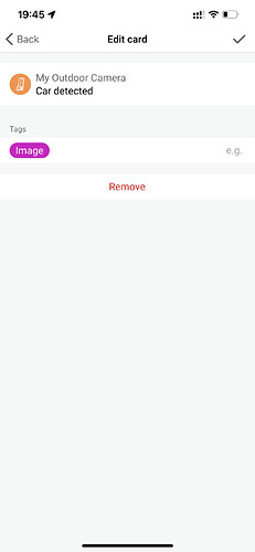

Gruijter when I test the flow like in the picture shouldn’t it work? I’ve been struggling all day to figure out why it not open my garage, in the picture I try to show you should I use image card or my outdoor main card? I have only one camera
I cant tell. It depends on your setup. I suspect you need Main.
Debug your flows step by step.

Is it normal that the card is grey out?
https://homey.app/f/7_o0oP
