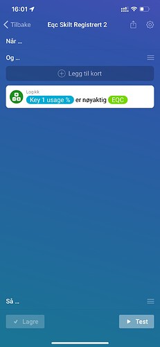

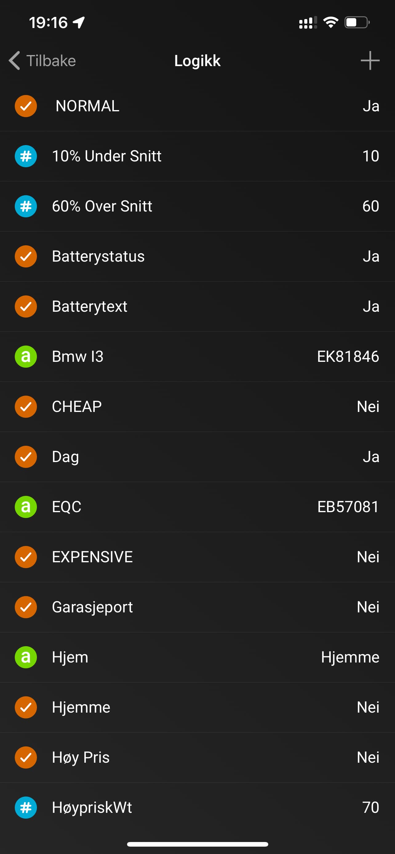

Can i ask key1 Logic where do you Edit? Or is it in «when»card with a logic card created for the car?like Bmw with register number Logic card?
You need to enter the api key in the app settings.
API key is written! Doesn’t work? Can someone tell me what I’m doing wrong?

The app seems to work fine judging by the logs.
  1. Test the flows. You can try your flows with the built-in test image.
  2. Check the image quality from your camera. You can send the image to your facebook messenger or signal messenger using this app: CallMeBot App for Homey | Homey
  3. Try removing the NO region in the app settings.
