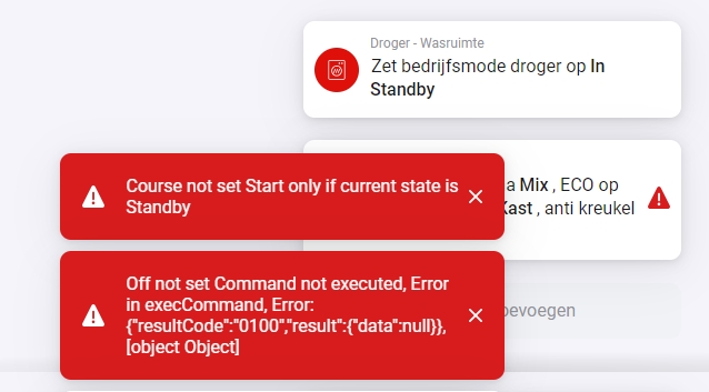

Ik heb een droger type RC80U2AV0Q
Als ik deze in standby zet, dan kan ik deze na een korte periode niet uit standby halen. De opdracht “Zet bedrijfsmode droger op Uit slaapstand” wordt succesvol doorlopen
Log:
undefinedundefined-Invalid Date-undefined undefined err] [Driver:ThinQDryer] [Device:dbbbef23-ee9c-4e7a-8813-45af51037c1a] execCommand Droger {“command”:“Set”,“ctrlKey”:“WMControl”,“dataSetList”:{“washerDryer”:{“controlDataType”:“POWEROFF”,“controlDataValueLength”:1,“controlDataValue”:0}}} Error: {“resultCode”:“0100”,“result”:{“data”:null}}
2024-11-13T16:13:42.122Z [log] sendCommandToDeviceWithRetry 0 undefined Error: {“resultCode”:“0100”,“result”:{“data”:null}}
at /app/lib/SmartThinqClient.js:746:23
at process.processTicksAndRejections (node:internal/process/task_queues:95:5)
at async SmartThinqClient.sendCommandToDeviceWithRetry (/app/lib/SmartThinqClient.js:757:24)
at async DeviceDryer.execCommand (/app/drivers/SmartThinqDevice.js:110:9)
at async DeviceDryer.executeOff (/app/drivers/ThinQDryer/device.js:242:9)
at async /app/drivers/ThinQDryer/device.js:154:21
at async DeviceDryer._onSetCapabilityValue (/node_modules/@athombv/homey-apps-sdk-v3/lib/Device.js:167:5) Droger
undefined-Invalid Date-undefined undefined err] sendCommandToDevice Droger {“command”:“Set”,“ctrlKey”:“WMControl”,“dataSetList”:{“washerDryer”:{“controlDataType”:“POWEROFF”,“controlDataValueLength”:1,“controlDataValue”:0}}} 0100 FAIL

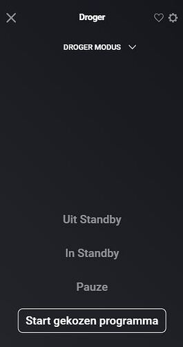

I recently bought a heat pump dryer of LG. But it seems it is not possible to start the dryer from within a flow. As far I can see there is no option to do this.
But if I look under the devices and select the dryer there is an option to start the chosen program
Is it a bug and is it possible to fix this?
Thanks you in advance!
Hereby also a screenshot of the device options of the heat pump dryer in the app to start a chosen program
Will open an issue for it.

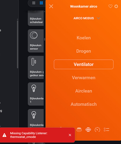

Sinds wat aanpassing in bedrade netwerk hier wat troubles met bedienen van airco’s LG met de app ThinQ @Martin_Verbeek
Wachtwoord gereset
App restarted
Homey restarted
LG app en Googlehome bedienen wel
In Homey telkens opmerking rood
Er is iets misgegaan bij het aansturen
Met detail
Missing capability listener
Heb een report aangemaakt
5aba9896-026c-4441-ae4d-7bfd13e05d9d
Andere ook problemen of iets lokaals of instellingen zoals nu blijkt ligt het elders
