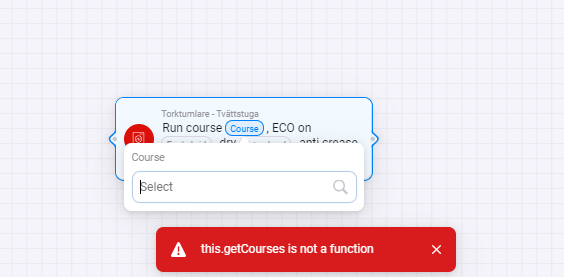

Hello!
Sorry for writing in english, my dutch is not at an acceptable level. I have added my dryer (Thinq2) and it seems to be working in the sense that I can see the status etc. However, when trying to create a flow that starts the drying process with a specified program I get the following error. Has anyone else seen it? It feels like I’m missing something but can’t figure out what.
Thanks
Andreas
Hi Andreas, looks like a bug. Will check it out.
