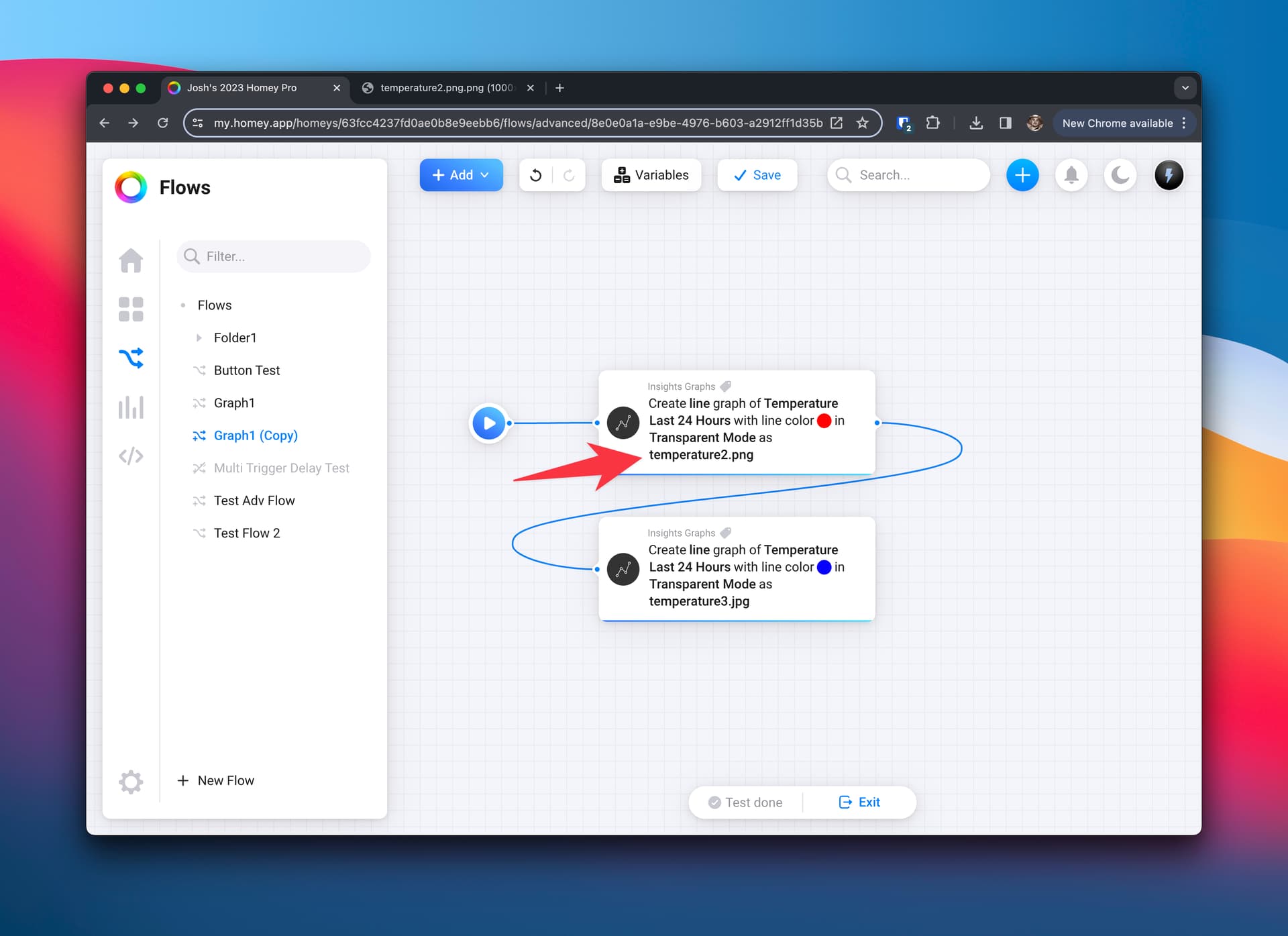

1. Create the Flow and output your image
Create your Advanced Flow using the Insights Graph card as desired. Make sure to use a unique name for each graph that you want to access.

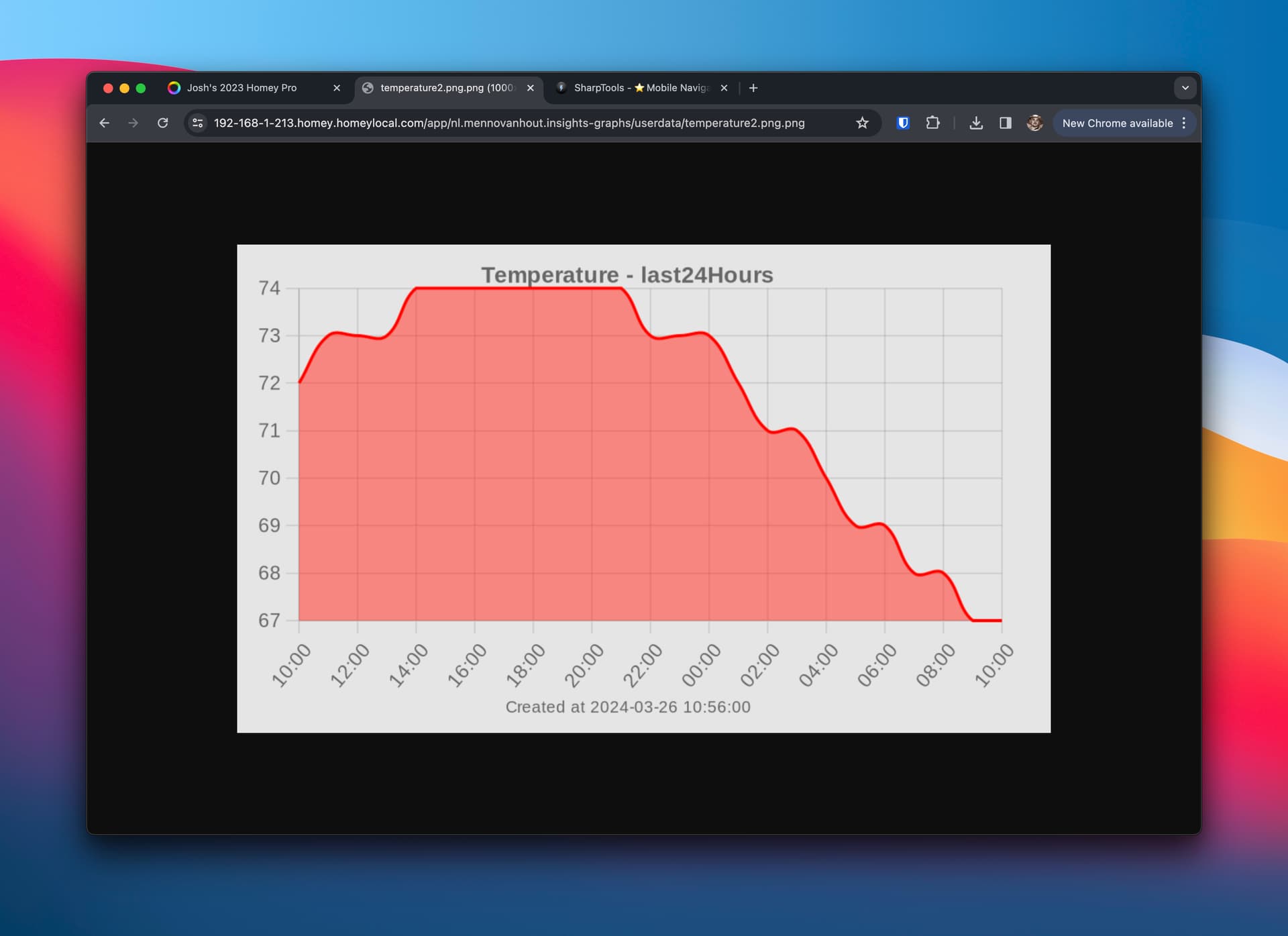

2. Construct the URL
Per the comments above, we can access the generated graph directly in the /userdata/ folder of the app. So we can construct a URL directly to the generated graph with a format like:
Format:
https://{your-dash-format-ip}.homey.homeylocal.com/app/nl.mennovanhout.insights-graphs/userdata/{yourFilename.png}.png
Example:
https://192-168-1-213.homey.homeylocal.com/app/nl.mennovanhout.insights-graphs/userdata/temperature2.png.png
Direct IP URL (tap to expand)
This direct IP URL format below is not for SharpTools. The above format uses Homey’s DNS resolver and has a valid SSL which makes it ideal for access in an SSL dashboard. Alternatively, you could use a direct URL to your Homey but it may introduce SSL Mixed Content issues, so it is not suggested for a dashboard served over SSL.
http://192.168.1.213/app/nl.mennovanhout.insights-graphs/userdata/temperature2.png.png
You should be able to access this URL directly in your browser:

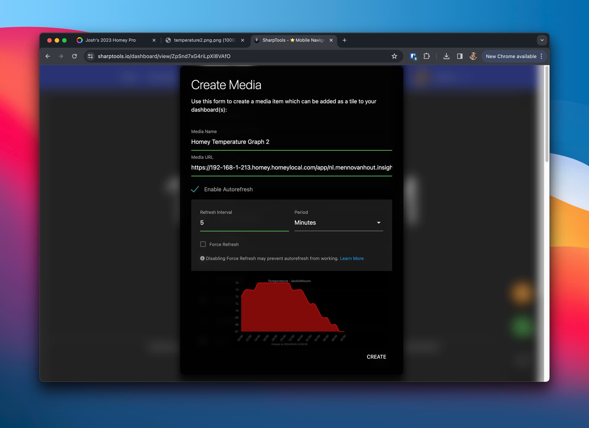

3. Create the SharpTools Media Item
Create a SharpTools Media Item using the URL of the graph image from the previous step. Enable ‘autorefresh’ and set the interval according to your needs:
