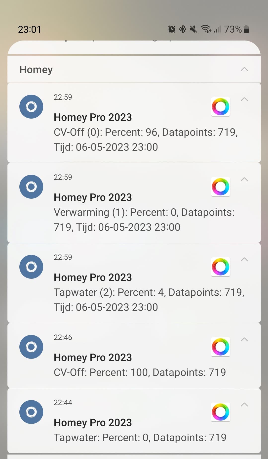

Hi @spkesDE,
I have installed the updated app and created the first test flow card. The first test is successful. I received exactly the right values (percentage).
The only thing I noticed is that the selectable “insight” value is displayed multiple times (I have only one “Toon_burnerInfo” variable). It is only a cosmetic thing, because it works perfectly.
At first, I saw a lot more, the number became less after a browser refresh but is still more than there are actually there. Maybe not related to the app itself, it can be a Homey general issue too.
Output of the test.
I will create tomorrow my calculation based on this new method.
Many thanks for the great update! I’m very happy! It makes my gas/warm water calculation a lot more accurate.
Best Regards, Hugo

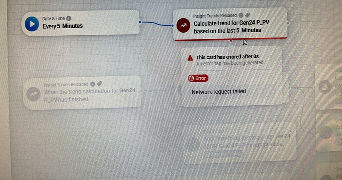

Hi!
It’s been workin just fine, but a few days ago I noticed that I was not getting any calculations done (average). Today I looked a bit closer and got an error: see pic.
/Johan
