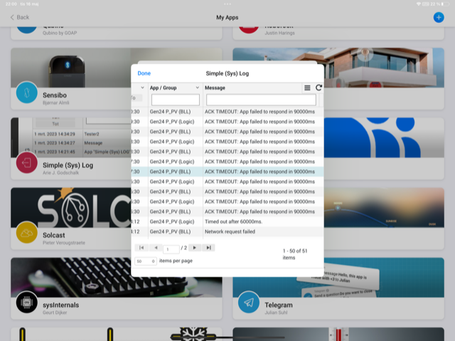

All of your errors are because it somehow fails to get the app information. Sometimes there are timeouts, but not that often. Please try this version and send a diagnostic report again. Maybe it will help me find the issue.
[err] 2023-05-16 19:32:16 [InsightTrendsReloaded] Could not get app information for app name.klep.homekittysage
[err] 2023-05-16 19:32:16 [InsightTrendsReloaded] [HomeyAPIError: Could not find that App] {
  statusCode: 404,
  description: 'Could not find that App'

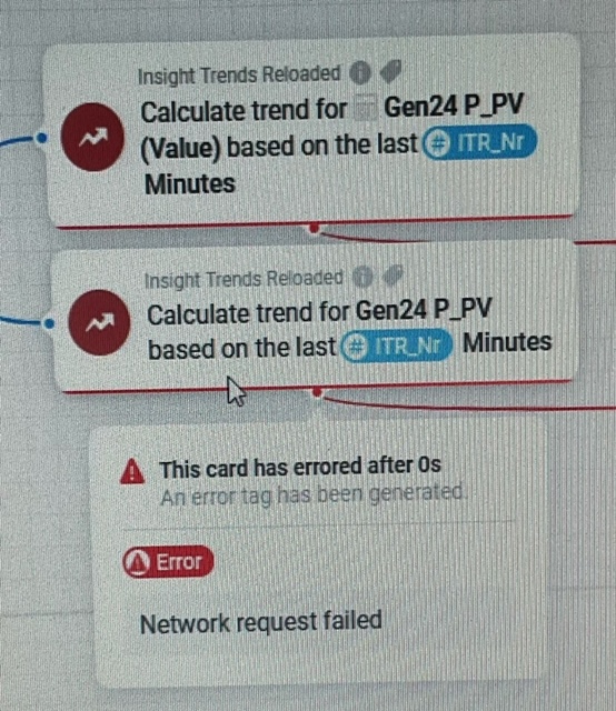

/Johan
Got network request failed

So now we are getting to the bottom of this issue…
The app can’t get the Logs for
  • se.tstorm.nicehashremot
  • com.paveld.tasmota (Strange since it’s my app)
Also It looks like some of you flows are outdated
Please reselect the devices/insights in the flow card it should fix the issue.
  • homey:manager:logic - variable-30fcc652-181a-4340-8a1d-36617d8b2a6d
  • homey:app:net.i-dev.betterlogic - Gen24 P_PV
  • homey:manager:logic - variable-41255c33-100a-4661-b6a6-8cce56d5f78b
All of these return a 404 - Could not find that log from Athoms side.
