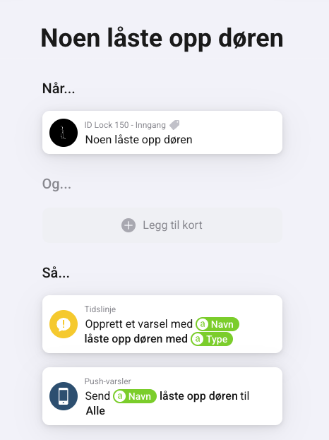

You can use the timeline card for that. My flow looks like this:
BTW I just updated the test app (ID Lock v2 | Homey), with a fix for pre 1.6 version if that’s selected in the settings
Hm, I copied your flow but the result isn’t there - it seems it can’t pick up the name and type from the lock. When I do a manual test of the flow(made up tags), it works.
This should be all, right?

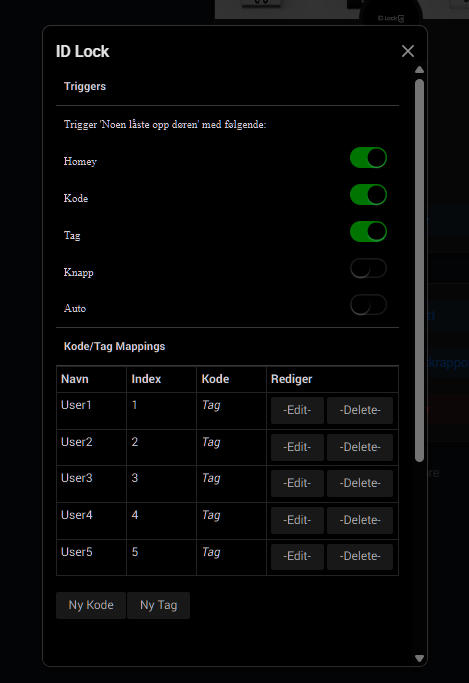

That should be correct. Could you check if you have the Code trigger enabled in the app settings? If so try to toggle it off and on again, as I remember having an issue with that.

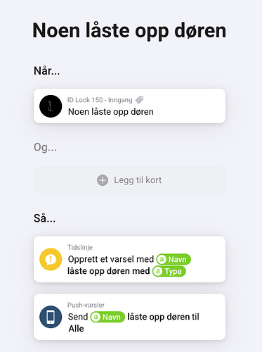

@joymyr Hei, sorry for noob question. But would you mind writing a quick step by step guide on how to get the lock to report tags used into homey? i have tried to set it up like this but i am not getting anything in the variable.
I am using the indeksing 1.6 er newer.
For me it just started working the next day - so if you do the manual test and it works, you can expect it to start working after some time. My flow is simpler than yours though:
do you have indeksing pre 1.6 or the newer one? found when you go into settings on the lock device.
Newer :+1:
But as I said, no notifications got through the day I made the flow. The day after they just started popping in. Maybe some delay between homey and the IDlock?
hmm i made this flow a couple of weeks ago. Maybe with this new update this will work.
