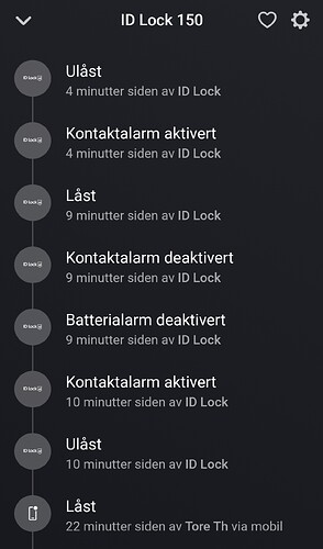

Also it doesn’t seem to identify which user/index unlocked it in the event log:
Could you check the “Set index mode” in advanced settings? It should be “1.6 and later”, but I think the default is “Pre 1.6”
For door unlocking you will need to create a flow which triggers on “Someone unlocked the door”, and it has a tag with the name.

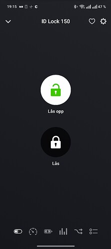

Yes, all z-wave units require the double inclusion step. Are you aware that just tapping the lock device/button will not lock it? You have to hold the button, then lock/unlock from there.
You need this screen:
