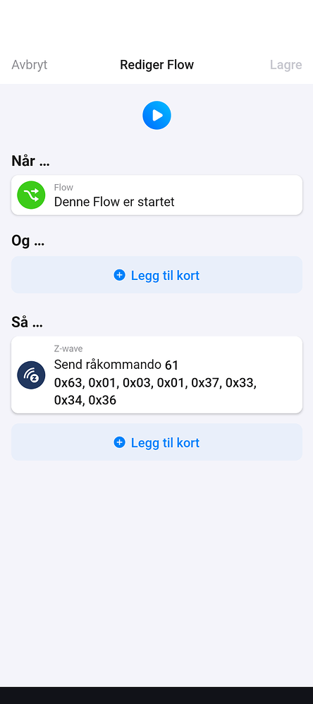

For setting user codes you can do this:
0x63, 0x01, 0x03, 0x01, 0x37, 0x33, 0x34, 0x36
The 0x03 is the index for the code (so like 0x04 etc)
The 0x37, 0x33, 0x34, 0x36 is the pincode. (change the last number in this to get your wanted pin) So this is pincode 7346
Husk å ha kontroll på index koden 1,2,3 så du ikke overskriver dine lagrede.
