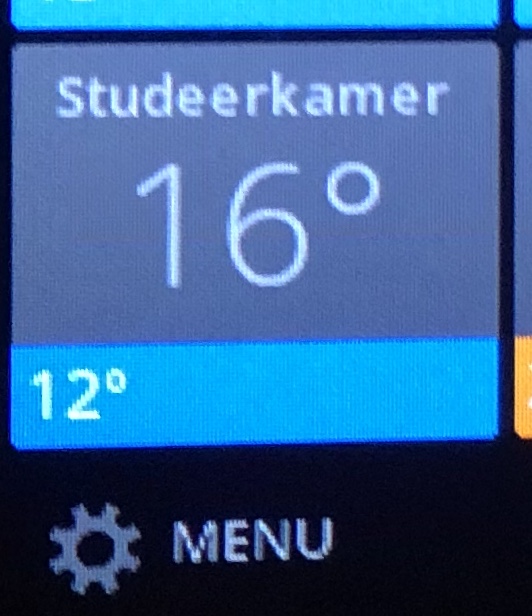

I have the latest HR92. When I turn the HR92 this is nicely shown on the controller.
The temperature setting is set until the next programmed temperature change
Evohome before changing the HR92 temperature setting:
Evohome after changing the HR92 temperature setting:

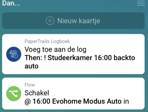

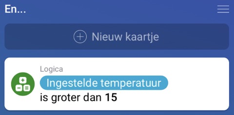

I have currently build some flow that work fine
This is triggered by every temperature change (so also by the programmed changes :frowning:)
My study is not programmed to be heated so the programmed changes never go higher than 15c. So I catch the manual actions by adding this:
This enables a flow to reset it:
This is the second flow that is enabled by the flow above (after manual action)
(The flow disables itself after execution)
This works nicely:
Adjust the te,perature at the HR92
Before:
After:
And after 16:00 it flips back to auto:
REMEMBER: there is a downside to this flow. The set to auto action will reset all changes made. So if any other controllers were also changes these will be reset too.
