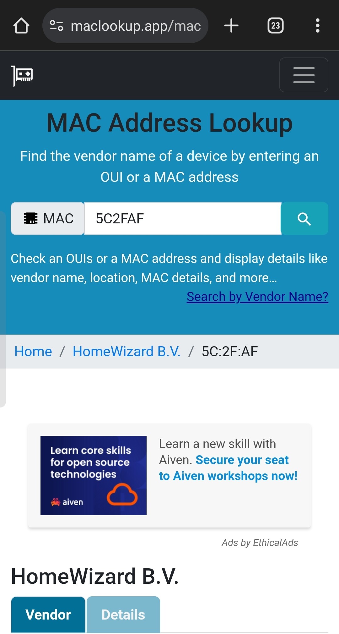

HWE-P1-G1
Software 4.19
ID = MAC= 5C:2F:AF:00:E9:52
Ah, thx, Theo!
It’s not the Espressif MAC range user nogren was mentioning,
but Homewizard seems to have changed it to an owned range now?:
My P1 still has 3C:39:E7:… btw
