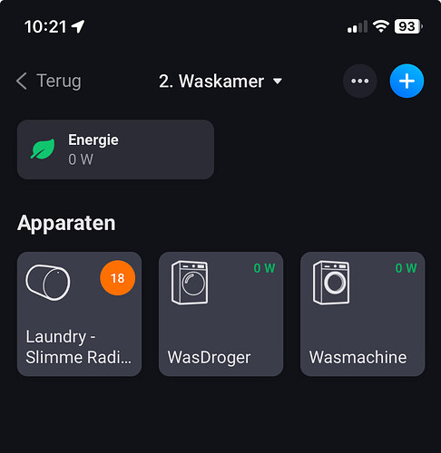

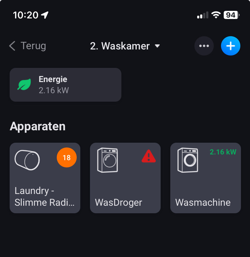

Just recovered from another glitch. After restarting the homewizard app in homey, things return to normal.
Screenshot homewizard ;
Screenshot homey ;
Restart app;
