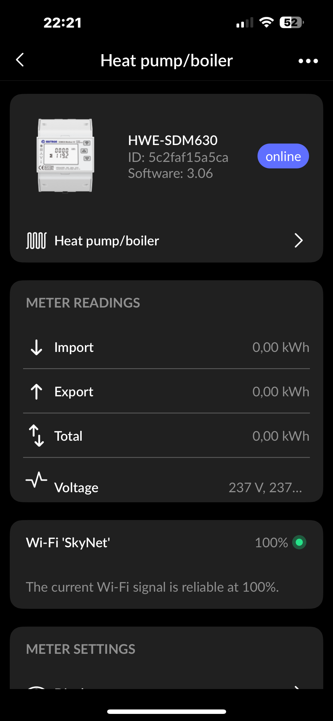

Could you do me one favor and share me the API output of your SDM630 to be sure that I get all the right data from the voltages? I dont have the kwh meter myself so not sure if I get it right.
Take a browser and enter (replace the x.x.x.x with your kwh ip address) http://x.x.x.x/api/v1/data
{“wifi_ssid”:“SkyNet”,“wifi_strength”:100,“total_power_import_kwh”:0,“total_power_import_t1_kwh”:0,“total_power_export_kwh”:0,“total_power_export_t1_kwh”:0,“active_power_w”:0,“active_power_l1_w”:0,“active_power_l2_w”:0,“active_power_l3_w”:0}
Hm no voltage there yet. What firmware is your SDM630?
Seeking activate_voltage_l1_v etc
Like:
|active_voltage_l1_v|Number|The active voltage for phase 1 in volt|
|active_voltage_l2_v|Number|The active voltage for phase 2 in volt|
|active_voltage_l3_v|Number|The active voltage for phase 3 in volt|
Newest firmware , i did copy all the info that i got from the link.
Maybe api does not cover voltages ?
Yeah seems the API does not have the voltages (yet).
This is the documentation I checked:
Maybe sent a support ticket when the voltages will be rolled out in API?
Yes
I’ve sent my API point of contact with HW an email if he has more info on roadmap for those.
Sounds good :blush: , let’s hope they can fix it
Yeah I hope so too, if not I will return your donation as it doesnt feel fair if I cant add it for you.
They will fix it but dont have a proper timeline yet so bare with me till they do.
