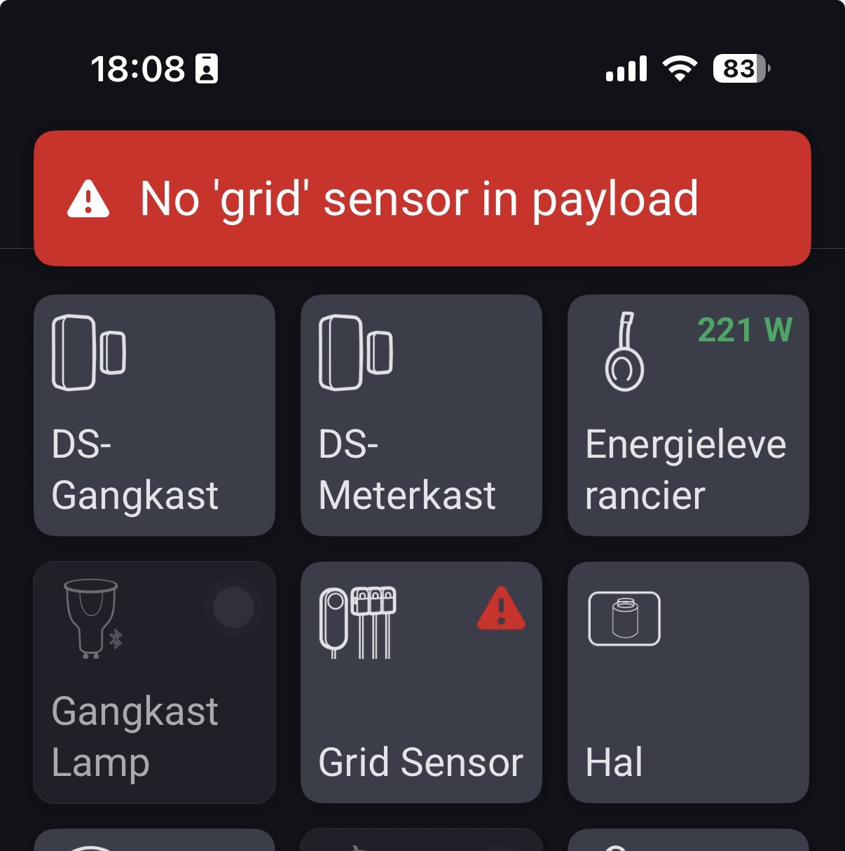

Since 1.4.1 update last Monday my grid sensor is not working anymore
The solar is still available just as the Homevolt itself
