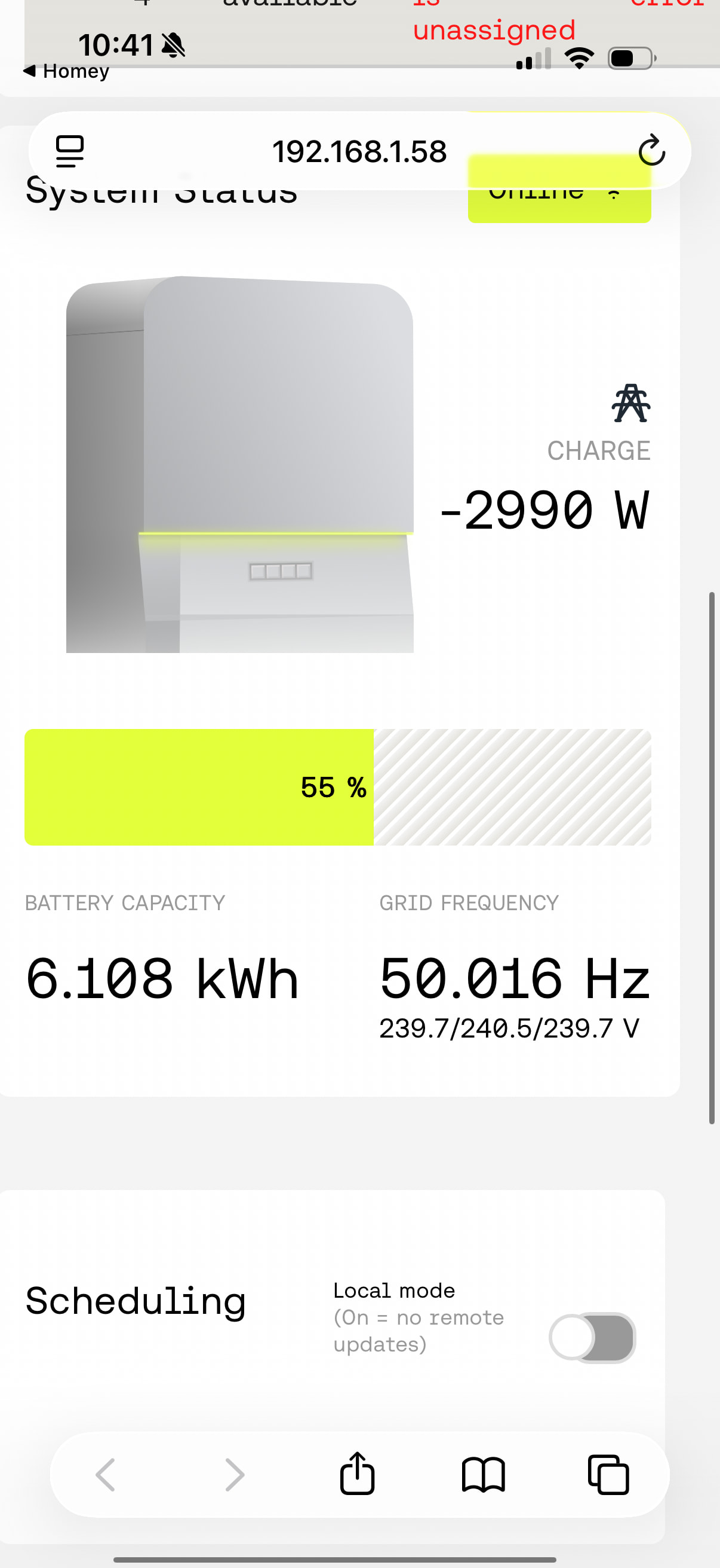

I have tried putting the slave battery in local mode too but it doesn't listen to it through Homey.
I have also tried a separat flow like that one I use for Master. But no change.

It’s a bit hard to troubleshoot from distance.
In short I’m using the local console to execute commands, so if you can figure out how control works there with multiple batteries that’s a good start.
