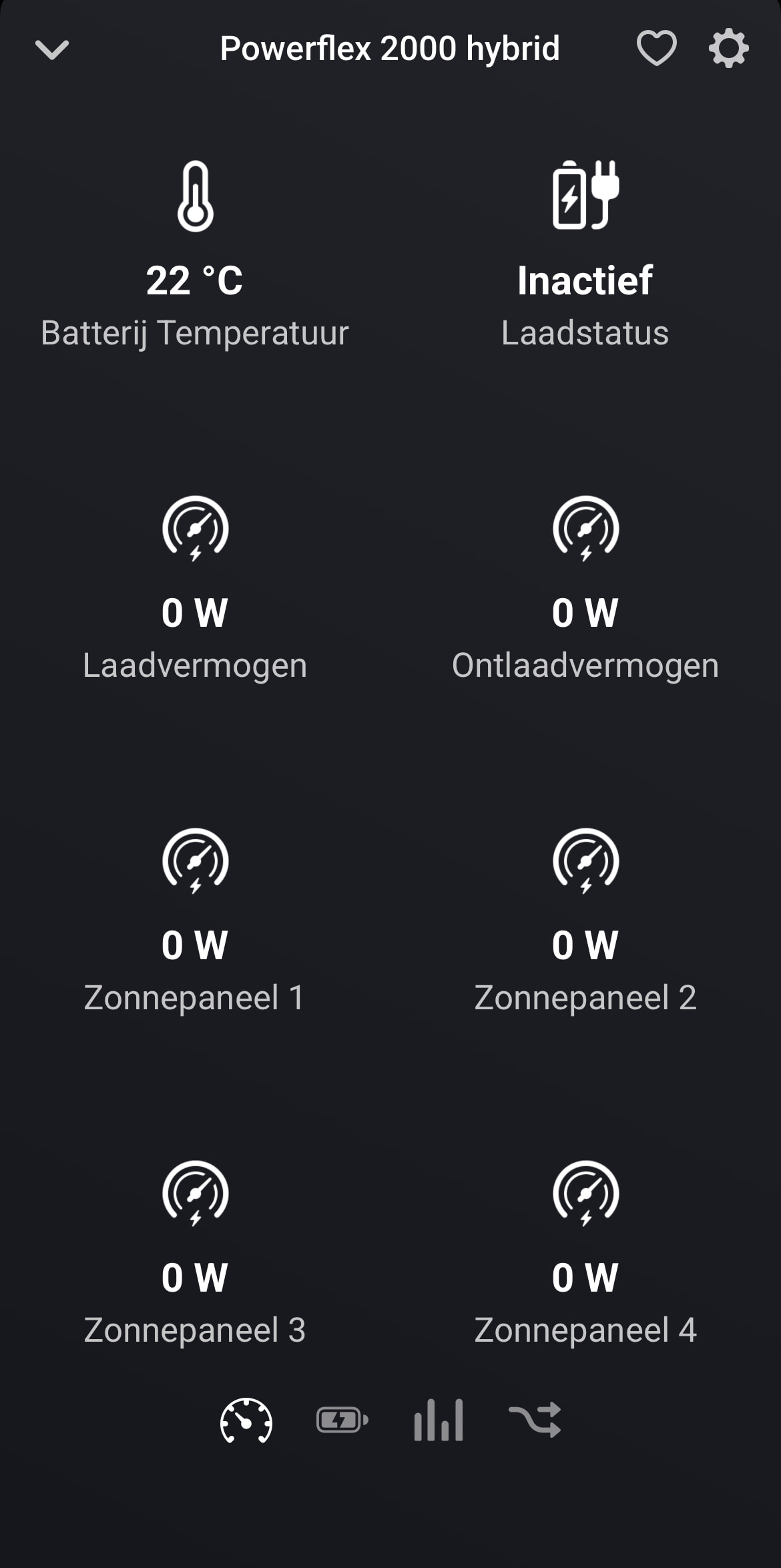

Hi Rchu57, thank you for this app. in the meantime i’ve also done some work in creating my own app.
With my app it’s possible to install the Powerflex hybrid and the eco. The app refreshes every 30seconds and for now it’s only showing information so you cannot change anything in the battery.
i would like to share this app for other users to do that i’m looking at the way to post it on github, if somebody is interrested please let me know.

Hi rchu57, i could not get it into the app store aldo i’ve managed to get it on github. You can find it here: mvandenbaard/homey-indevolt
If you are able to update it and upload it into the homey store you are more then welcome then everybody can install it
Thanks a lot. With a bit of tweaking the app is now published. With a lot of thanks to Marco!!!
It’s still in test by I think everybody can download it at:

Yes, great news! The app was approved for public release today. I just updated the version to production (v1.0.1) and added the URL to this forum to the App Store. This change will likely be published tomorrow.
If you previously used the test release, you will need to remove the devices to access all features (import/export available in Energy tab and meters import/export today en total added)

Found some extra time tonight, just updated the app to version 1.1.0:
Web service API calls rewritten. Now only a single call for all settings. An additional feature added: manually set the update interval. The interval can now be set between 5 and 3600 seconds in the device settings (advanced settings); the default interval is 30 seconds. For those who installed the test version, install the new app, remove the batteries in Homey, and re-add them to use all features. This is no longer necessary from version 1.X onwards.

New release for testing: v1.2.1
It is now possible to control the Powerflex from Homey.
Control flow action cards have been added for:
1. Retrieve manual update
2. Set operating mode (Self-consumed/Real-time/Scheduled)
3. Set State / Power / SOC values
A few important notices:
- It takes a moment for the changed operating mode to be visible in the Indevolt app. You will see this faster in a P1 monitoring app. The same applies to the charge status / power / SOC settings.
- If you have a cluster setup, only set the value for the Main (or Master). The Sub (or Slave) will follow these settings.
Also further code cleaning has been done.
Let me know if everything works properly after testing. I won’t push this test version to production until after a few days of testing (a lot of code has changed).
