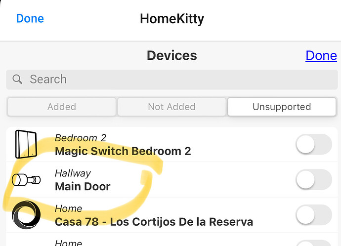

Dear @robertklep ,
Since the last update v2.2.7, the BOLD Smart Lock is not supported anymore.
Any chance to get it back? Thanks! :pray:
Support for this lock was added in v2.2.9, so you need to run the test version of the app.
