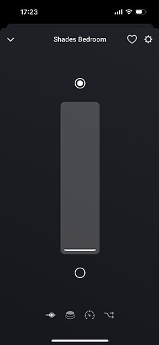

I have the same problem with the Velux Shades and Window.
Homey doesnt show the current status of the shades/window, and clicking on the icon in the “units” doesn’t do anything. (I would expect it to either open or close the window/shades.
Are you running latest test version?
I just updated to 1.1.15 and rebooted Homey. Still the same.
