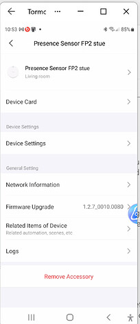

Well, now I have gone through all the 6 steps you listed, but the FP2 still doesnât appear in the pairing dialog.
The way I deleted FP2 from the Aqara app was using the Remove Accessory button (see attached screenshot). I noticed when adding FP2 again, I did have to connect to my WiFi again, but I didnât have to scan the QR code. Also all my Zone settings in the Aqara app were cept as before. Is there something more I should do concerning deleting and adding the device?
Anyway going through this process didnât help, the FP2 still doesnât appear in the pairing dialog i Homey.
Iâm confused, it worked after several tries yesterday, but today notâŚ
No lamp on FP2 is on after the 6 steps are done.
