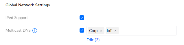

Are you using VLANs and if so, what brand router are you using?
Yes. Ubiquiti unifi
What’s the IP address of your Homey?
192.168.3.35
Given that Homey and the FP2 are on the same network segment, the EHOSTUNREACH error seems to point to a router or firewall that is blocking Homey’s connection to the FP2 for whatever reason. That would ultimately be a local networking issue.
