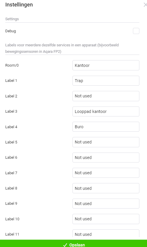

No you dont need that. There is a custom card for zone became active/inactive for the FP2 zones. The standard Homey active/inactive for a zone is also available but only for the FP2 sensor as a whole.
FP2 without zones has motion and zone active for FP2 as a whole
FP2 zones defined will ADD zone active/inactive custom card.
You can give the zones a meaningful name in the advanced settings of the device.
Settings (all Dutch but i hope you get the idea)
Select zone to become free or occupied:
Select zone to be active/inactive for a duration:
