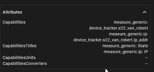

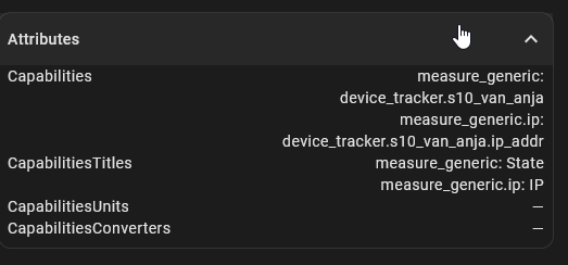

I changed the device namez, now both are present but the STATE detail is faulty on 1 device, it shows the connection instead of the state, the other device is correct…
2022-11-08_ 215856
2022-11-08_ 215842

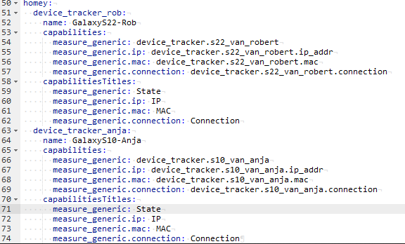

As far as i can see there is no error in the yaml config, for both devices they are identical, expect the device names of course:
2022-11-08_ 220328
Can you please check the entity details in HA for your first tracker? The entity is named “homey.decice_tracker_rob” in your case. Just to be sure that the entity has correct assignments.
yep is correct.
I even removed the last 2 measure mac and connection (of both) types and re-added both, problem is the same.
2022-11-08_232726
2022-11-08_232742
When i only add 1 device then it is OK, doesn’t matter which one i add, but as soon as the second one is added it goes wrong

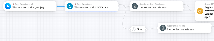

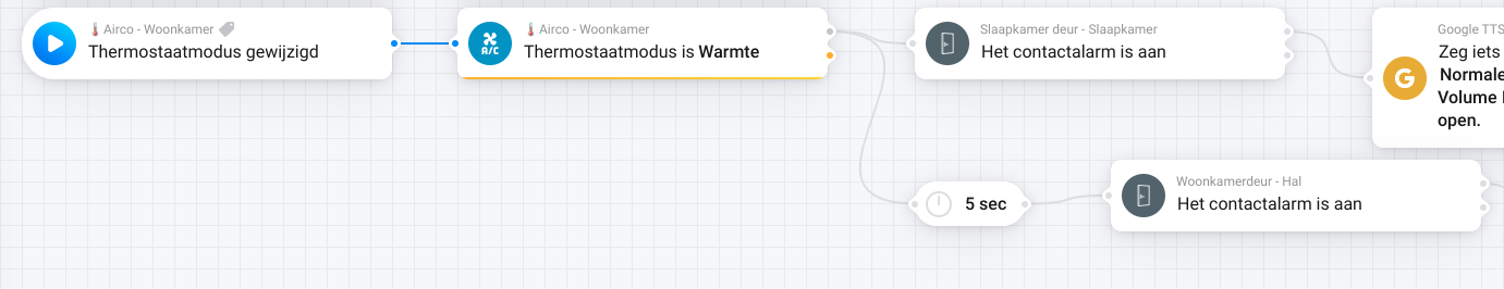

Strange thing is, AND colums are working now in flows, but not when I test a flow manually… Any idea?
How do you test? Can you please share a screenshot?
This flow by example. The flow is working, but when I test it manually its not.
