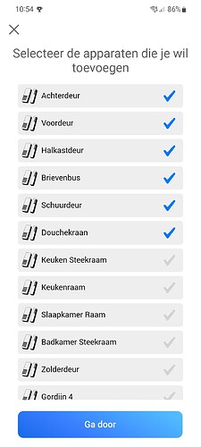

Thanks for this great app! It will be nice if there is an option to select more than one device when adding new HA devices to HomeyâŚ
this is a default behaviour of the Athom pairing dialog. Itâs only possible to activate single selection or multi selection with ALL entries preselected. So if you have 500 HA entities and want to add 5, you have to deselect 495 ![]()
And the new version allows to add individual icons. So you perhaps want only to add 1 device in a step to do this.
Aaaaah understood! But if you install te app for the first time, you have to add all 500 devices one by one. Maybe it is possible to add an option in the settings to choose? So, select all of them, or just one?
According to Athom this is being worked on⌠itâs an Homey thing not an app thing

Perhaps the Deconz app has made an own view or copied/modified the Athom one.
There are other apps with icon selection (VD, MQTT hubâŚ) where you can select one device, select icon and add device.
Most usecase will be to one by one into different zones/rooms.
