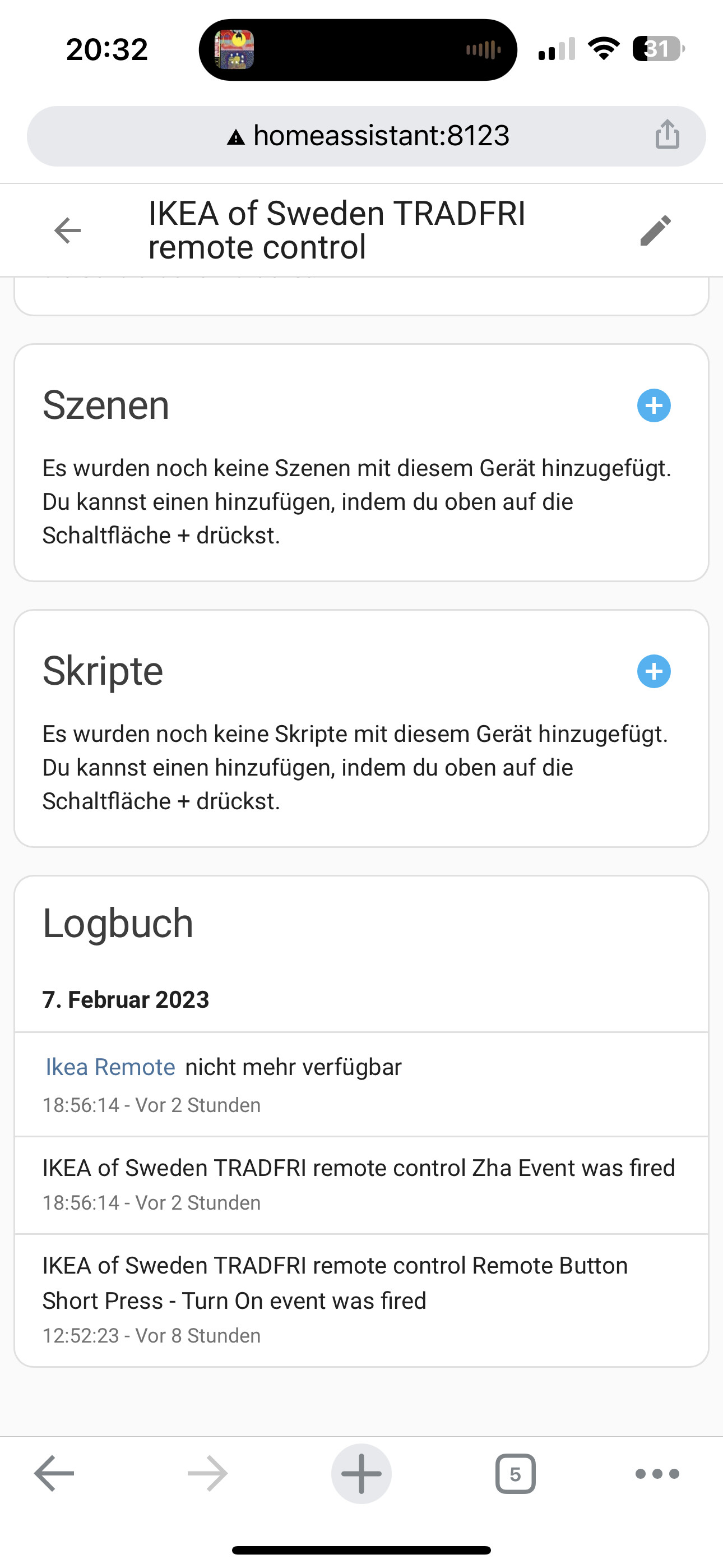

Ok. The Remote fires Events.
I’m just testing at the moment. I only use the button for testing. but I installed some of them in the wall. works great with deconz and Homey.
Can you please log the event and send me the JSON data?

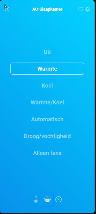

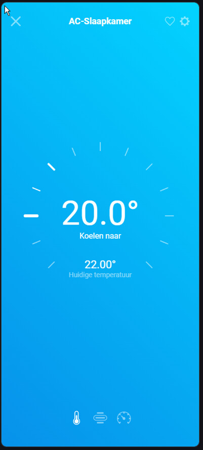

However, I noticed some issues related to the climate device integration:
  1. The card temperature remains colored and bright even after the device is switched off. You have to open the card for this device to verify if the device is operating or switched off. This is illogical.
  1. The colour of the first card has a blue colour. I’m not sure if this colour is corresponding with the chosen mode of operation. If so, in this example the mode of operation was heating and then it is more logical to select a red or similar colour. If the device is switched off, the card should not have a colour at all (transparent)? Or is this just a random selected static color for this device type?
  2. The text “Koelen naar” on the first card is incorrect, it does not correspond with the chosen operation mode (in this example, the modus was “heating”).
  3. The last card is an unknown setting or feature for me (“werkzaamheid”). This may display the current operation if for example auto or cool/heating is selected, but I’m not sure about this.

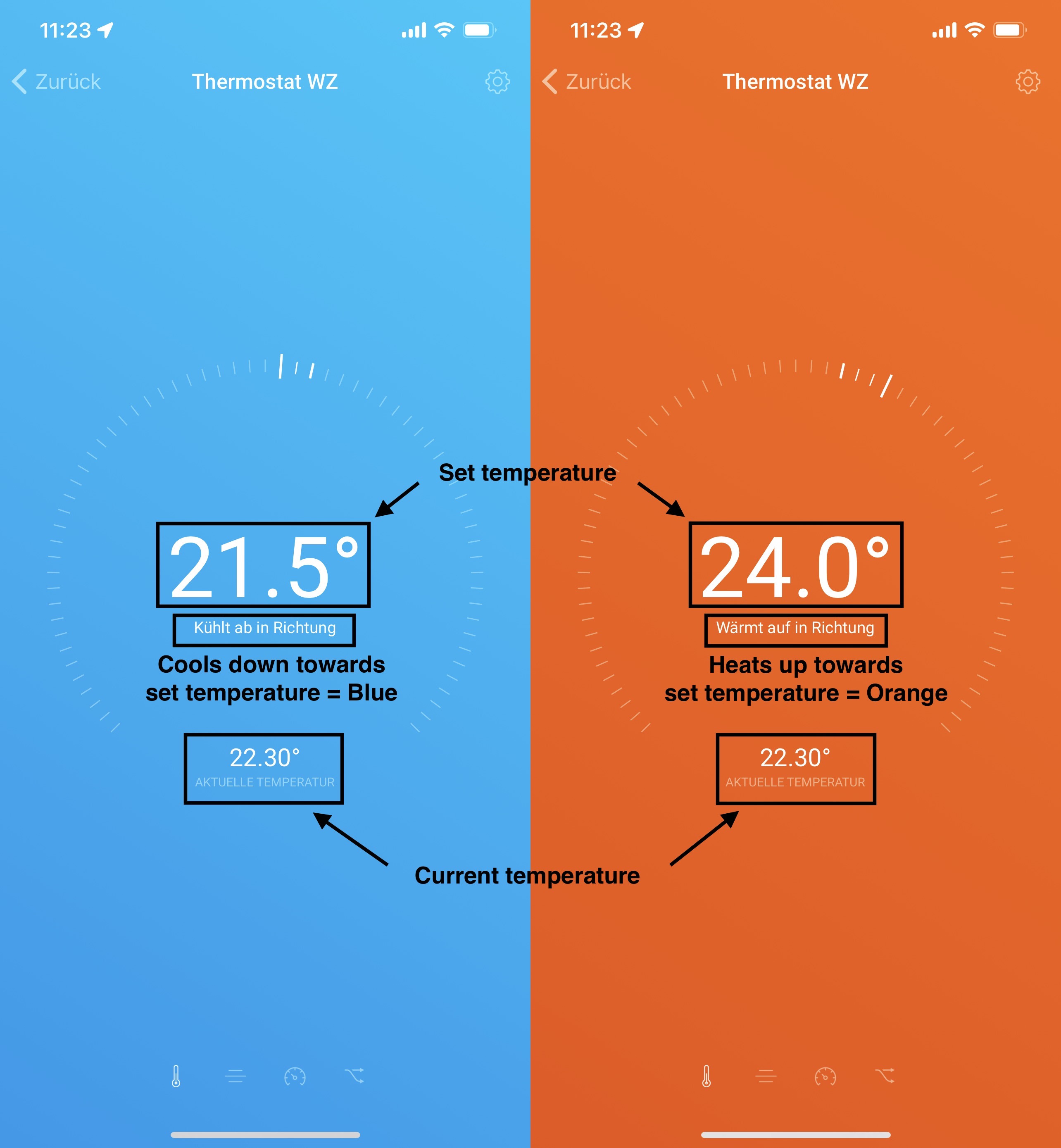

The color blue is displayed because the current temperature (22 °C) is higher than the set temperature (20 °C). That is why the first screenshot also says “Cools down” (to the set temperature), even if the mode is set to “Heat”.
This is the standard behavior of Homey for thermostats. So these are not errors in the HA app.
(This thermostat is not integrated via the HA app!)

  1. Like @fantros has shown in the screenshots, the coloring is only done in the GUI dependent on current/target temperature.
  2. Koelen naar (cool to) is shown in the GUI if current temperature is higher than target temperature. It’s only the GUI. The app can’t control it.
  3. werkzaamheid is a bad translation. It sould be “Activity”. This field is filled in special cases if the HA entity doesn’t use the predefined modes and the mode selection can’t be used. Then you can see the current state/activity as text. I’ll change the translation to “Activiteit”. I hope that’s better. Thanks for the hint.
