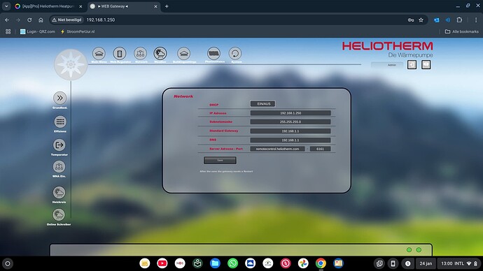

Hello Jeroen. I am trying to connect my heat pump to the app.
I have activated modbus TCP on the heat pump.
I have to say that I have a previous version of RCG.
The RCG is connected to the home network by wire.
When I look at install devices in the Homey app, I find the Heliotherm app. When I click on that, I get to a screen where I can indicate what I am looking for. But I cannot figure out what to enter there. Then I also have the option to click the “Heat Pump” button. When I do that, I get to the following screen that says: This action connects the Heat Pump to the Homey. Then I click on the “Connect” button.
After searching for a while, the answer comes: No new devices have been found.
And then the car stops. Intuitively, I think it is because the pump is connected by wire. But is that the case?
I hope you can help me further. Kind regards, Baltus.
Did you follow the instructions on Domotica to enable Modbus over TCP/IP and then restart the heatpump (very important).
After you did this successfully the Heliotherm Homey app will find your heatpump and you can add the device. See screenshot below of (Dutch version).
Dag Jeroen. Bedankt voor je snelle reactie. Zoals ik al meldde, ik werk met de vorige versie remote control. Daar staat ook een ander server adres in. Ik doe hier wat plaatjes bij zoals bij mij e.e.a er uit ziet. (sorry ik kan als newby maar 1 plaatje per reply toevoegen
Met vriendelijke groet, Baltus
