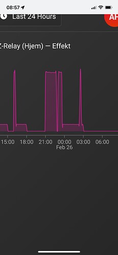

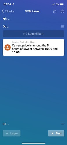

I have investigated this further and it Looks like The condition with lowest price between x and y reset at midnigt, i.e. If I set it to lowest 5 prices between 16:00 and 15:00 and there are low prices before midnight it could possible be 5 hours before midnight and 5 after midnight not 5 in total in the time period.
In The example below it has triggered 2 hours between 16:00 and 18:00 and then 6 hours from 21:00 to 03:00, i.e 5 hours before midnight and then 3 hours after midnight.
