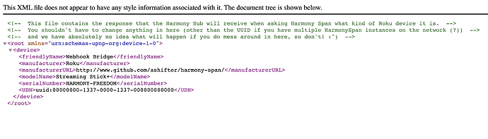

Noob here, need some help setting Harmony-Span up on my Syno.
I followed all the instructions and got no errors installing on my NAS. Now I would like to access the Harmony-Span setup page. It states it is located at the IP of my NAS, but with port 8060.
That opens a XML page and states:
Where is the setup page? Or am I missing something?
UPDATE
I see I have to add /config to the URL.
Unfortunately, now I can’t even access the earlier visible XML page.
Coffee first :wink:
I have not added anything to my Harmony setup yet.
If you can’t find the page when browsing to the url (with /config) then the node server is offline, that will happen if you close the ssh client (with the script running) for example, without loading it, either on reboot, or with another method so it runs in the background with something like “forever” npm.
